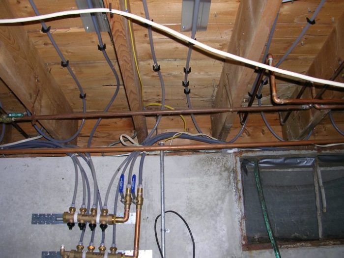

Here's a pic from a professional installer
Most codes will specify where notching/drilling is allowed, what size, and in what location.
I personally have not seen a building code which restricts small hole like those shown above. That doesn't mean some jurisdictions have a different requirement...but I would be very surprised...this picture is from Seattle which has earthquake codes...not sure where you're from...well you get the point.
As far as insulation...the heat will go somewhere...it just a matter of where. If you want to have control over that - then insulate.
