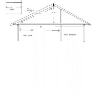

I am currently remodeling a backroom and would like to raise the ceiling, and am unsure exactly how high I can go.  I would ideally like to raise the joist/ties to 8′ off the wall  as measured along the rafters to facilitate 2 full sheets of rock, although it is not essential.
The existing roof is a 4-12 pitch, 10 feet wide and spans approx 14-16 feet from wall to ridge. All 2×6. The ceiling joists play double duty as collar ties, also 2×6.  Distance from the top of ceiling joist to the ridge is 4’6″.
I am in New England so snow load is a factor. Looking for a little advice.
I have attached a small diagram.
Thanks in advance.
JRE
  1. Piffin | Jan 11, 2004 11:40pm | #1
    need some clarification here.
    Did you mean eight feet offff the wall?
    How high is the ceiling now?
    if it is built as drawn, you have a problem because the rafters sit on a cantilever of that ceiling joist. Is that an accurate representation? it is not a typical detail. are you certain these are not trusses. You show a ridge beam so I would assume it to be stick framed.
    if stick framed, the roof rafters are probably barely sufficient for snopw loads at the span and pitch. If you raise the ceiling, it would likely hang from the roof rafters instead of sitting on the wall. That would add the weight of the ceiling to the rafters and could make them sag.
    Another problem is that it would appear that you would only have 5.5" for iunsul;ation for a portion of the roof. How do you feel about roof leaks from ice damns?
    1. slykarma | Jan 12, 2004 05:25am | #2
      If the detail is accurate, this is not at all a good situation. Hopefully the rafters are birdsmouthed into the wall plate in the conventional manner. The roof looks overspanned already with no collar ties and low angle in high snow load area.
      There are ways of lifting the ceiling, but they would almost certainly mean reframing the roof. The room is not that big at 9x10, unless the ceiling is well under 8' I would be inclined to live with it and spend the reno budget on something that would offer more return; ie, main living areas or bathrooms that all can enjoy (and offer better resale value improvement).

  2. FastEddie1 | Jan 12, 2004 05:27am | #3
    My 2 cents:  Talk with an engineer.  Have him/her spec a new beam to go under the existing ridge board, but supported only on the two ends.  New beam should be sized to support both the existing ridge board, as well as new rafters from the new beam to the exterior walls.  What you end up with is similar to a scissors truss.  Looks like a 10 ft span, so the new beam will probably be only about 12 inches deep, so you will gain almost all of the attic space for the new ceioling.  Course I don't deal with snow, so Piffins comments about ice dams may be a problem.

        1. Mastermech | Jan 12, 2004 07:54am | #7
          Well, the results are very disheartening. But I appreciate the input.
          The ceiling  in this room is at about 7' now and I wanted to open up the room a little. I had planned on going 8' diagonally up the rafter from the wall. The rafters are birdmouthed. and as for the detail in the diagram above the wall, these are nothing more than an extention of the wall to the rafter. The are 2x6 and run from top plate to the underside of the rafter. I was planning on building out enough off the rafter to add some additional insulation although the amount is limited by a window.
          Of course all this seems a mute point, as you say the construction of this roof leaves a little to be desired.
          Thanks again for the advice and input, greatly appreciated.  Now I  will go cry in the corner.  Haha.

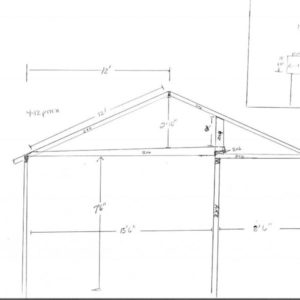

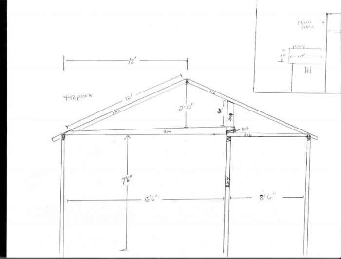

    1. Mastermech | Jan 12, 2004 09:13pm | #9
      Got the entire ceiling torn out and have revised the picture for you. Looking to see if anything changes with this revision.  Although I think this arrangement is most likely worse off than before.

        deadmanmike | Jan 12, 2004 09:41pm | #10
        OK, I'm not thread hijacking here, but I have a VERY similar situation. Same roof pitch and framing(mine is 2x6, 16"OC), Same room width, but ridge to wall is only 10' for a total 9'x20'. I'm redoing the kitchen soon and I'd like to lose the 7' ceiling, "cathedral" it, and add a skylight. I had planned on double 2x6 collar ties every 3' or so, 8-9' up, and either sistering in 2x8 rafters(I'll be adding anyway with the leaker) or firring the rafters to allow for air channel and insulation. I have another room with exposed(faux) beams and don't mind at all. Maybe this is an option for Mastermech.

        1. csnow | Jan 12, 2004 09:58pm | #11
          The problem with the 'collar ties 8 to 9 ft. up' is that you are transferring the spreading load from the ceiling joists to the collar ties AND the lower couple feet of the rafters.  With a low pitch roof the spreading load is higher, and the rafters may not be up for this.  The collar ties also concentrate a point load on the rafters where they attach.
          Many structures are built this way, but are [generally] engineered accordingly.
