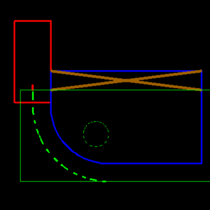

I’ve a Dewalt DW721K jigsaw, and a lot of 6″ radius cuts to make in 1-1/2″ framing lumber. Recommend me a blade. Thanks.

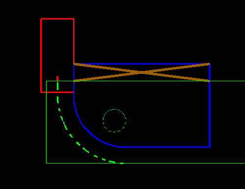

Here is what I am doing. The pic shows a plan view of the jigsaw sole with blade, upper left, positioned against a jig clamped to the end of a 2x8 (#2 SPF), ready to make the cut. The saw will be freehanded around the curve, with sole held tighty to bear onto the jig face, the bearing point always against the point of the sole adjacent the blade front. The hole profile shown dotted will be bored after, in the drill press. It's my decorative rafter tail. I have used Bosch T-shanks in my jigsaw, both Progressor-type and regular. Do you think the Bosch T244D blade is the right one for this?
I know, I know. Some might say, "just get it set up and try something," but, hey, they don't call me Mr. Micro for nothing. I figure someone has done something like this before and has resolved things knowing just the right blade.

Went to the Bosch site, and it turns out the progressor blades are for straight cuts. That is what I have done when I used them. If I can get some of the T244s locally, which I doubt I can, I will try them in some 2x stock. I have asked Bosch what might be best, through their website, but have no reply yet. Go there sometime and see how many different blades there are, just in the t-shank style. Bewildering!
Haven't tried the 244. If it's skinny, I'd be worried about deflection. You're not cutting that tight a curve. I've got some progressors, I'll take one for a test run on a curved track, tomorrow. Does your DeWalt orbit? EliphIno!
Yes, my Dewalt orbits. It has variable speed, also.
I tried the Progressor on a yellow pine 2x with your approximite curve. Set on high orbit, it cut fast and pretty square. It's a little rough, but would be easy to touch up with a belt sander or sanding block. I'm not sure why Bosch sez it's only for straight cuts. I also tried a144D and the 101B, both on high orbit. The 144 also cut fast and a little rough, but not as square as the Progressor, and the 101 cut slower, smoother, but not squarely. All the cutting was done with the grain and not into it.
