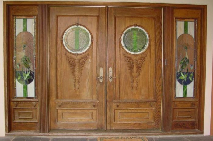

A potential client has asked me to refinish their entry doors and sidelights. I do a lot of door installs, the painter that I work with is on vacation for two weeks, and I need to get to this soon.

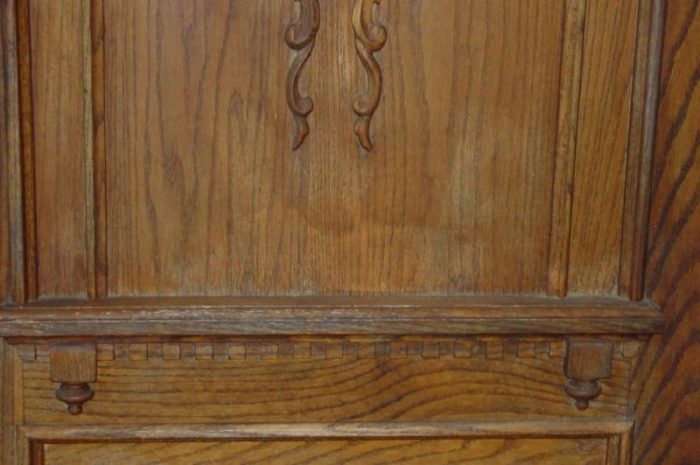

The door is under a covered entry. The gutters are full, so some water is splashing back on the left side, and the finish is flaking off. I’m not sure what the finish is. The brick mold and fluted columns seem to be mahogany. I think the doors are white oak. Appears to be something like a golden oak stain which has darkened a bit. There are also numerous spots of water staining.
Everything looks sound.
I’ve used various forms of oxalic acid on oaks and had mixed luck. Since the sill is the worst (and greyest), I thought I might sand and stain that darker and use Waterlox Marine finish.
I’m not completely sure how to strip the old finish off the doors and sidelights. Any ideas. The owner’s don’t want a shiny finish and are leaning toward Waterlox tung oil finish, which I have had good results with, as long as it was cleaned and kept up with.

I think you will hate yourself for taking this job before you're done. It will be almost impossible to get this looking good with a light transparent stain like it has on it now. You will need to upgrade it to a semi-opaque finish or (even better) a painted finish. If you do manage to get a decent look without adding a lot of pigment this door will need at least annual maintenance repairs to the finish. Exterior doors finished bright are all that way. This unit has a ton of crevices and stripping will be an absolute heartbreaker. Talk them into a painted or semi opaque finish. If I was your painter I'd make DAMN SURE that I NEVER found time for this job.
I have to disagree with ya here Clay. Not that he may regret doing it.lol but, it can and has been done..I personally have done it to at least 5 various entrance systems.
Paint it? Not on my watch. Stirpping it may not even be needed, first the finish needs to be determined, and second whether or not it ever was actually stained..most likely it is just yellowed or altered by the actual finish itself..Probly a long oil varnish, factory or endused applied.
A good going over with a TSP and bleach soak..followed by a gentle pressure wash, a bit of sanding and he may just be in like Flynn..oil away.
Granted all exterior finishes (even paint) need periodic maintenance..but to paint that door way IMO would be assinine.
Yeah there won't be any painting. These are handsome oak doors, and everybody wants to keep them that way. I am going to give them a good, careful cleaning with TSP, then I will be able to assess the situation a little better. But I think the pressure washing is out cause of the stained glass. I don't want any leaks to the inside, because it really is really nice. The owner's now understand the importance of maintenance, so I think they will keep up with whatever I put on.
Clay may be right about having to go with a darker stain. We have discussed it, and they're ready to look at samples.

Billy; Whether the stain is darker or not is unimportant. More opacity is the key. That can be accomplished with a light tint too. I would probably go for something along the lines of a buckskin tan. I usually have to mix my own using my clear finish as a medium and adding tinters. A buckskin tan uses white, raw sienna, burnt sienna, and raw umber (mostly ... sometimes a dash of this or that is needed to get the tint just right). I don't like to do such things with stains. I usually use glazes (which are simply thin, tinted, varnishes or other clearcoats). The advantages of glazing are that they have some body and will adhere to the surface so that color can be built up in multiple coats giving you very accurate control of opacity and hue. A light glaze that roughly mimics the original wood tones covered with one or several coats of darker (though quite transparent) glazes does a decent job of imparting the look of depth that bright finished wood has. The light underglaze effectively covers most of the gray weathered areas(it can be applied more heavily or with an adjusted tint to minimize the contrasts of the weathered areas).

I have done a lot of refinishing on boat brightwork, it's just in much smaller areas than these doors. I haven't used this stuff before, but it might be just the thing: a little tung oil, a little spar varnish, a hint of polymerization.
http://www.tungoilfinish.com/marine.htm
I don't want to do too much sanding, because of the patination. Does anybody have a systematic approach towards blending in the water spotting? One big spot<G> Don't worry, we can fix that later!
I'm with SPHERE on this one... That doesn't look to hard a job at all. A little time with a detail sander can get to the inside corners and edges of the panels that are greyed. the rest can probably just be lightly sanded with 120 grit. Then i'd apply a good grade of spar varnish. Yeah, the stuff is shiney... Somebody probably makes it with a flatner added, though I don't know of any. You can always finish it with gloss varnish... let it cure a couple weeks and then wet sand it with a scotch brite pad to get a satin finish.
I think Waterlox... even the marine stuff is way to high maintainence for me. There has got to be a reason why boat people are still using $80. a gallon spar varnish... If there was something better, they'd be using it.
That's a beautiful doorway... be damed if I'd paint it!
I thought I didn't know much about this until I read some of the other replies--don't mean to insult anyone, but I hope those who said replace or paint the doors were kidding. I agree with the first reply about first cleaning the gutters. I don't think the finish could be anything but varnish, if they're as old as they look. Shellac or lacquer wouldn't have lasted a year outside. I'd strip the old varnish, maybe use a brass wire brush if needed, maybe a little sanding, perhaps Golden Oak stain and then spar varnish. Stuff has UV protectant in it and shouldn't flake off like polyurethane. That's my 2 cents.
