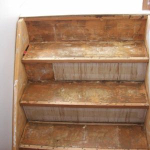

I have just finished taking the carpet and the tiles from the stairs. I was going to get some GLUE REMOVER, but I am not sure if it is worth it. I was looking at Lowes, where they have oak risers on sale for $19.99 (just oak veneer with particle board). But I am not sure how I want to approach it. I would love to just remove the paint and sand down the cedar and paint it white, but I know it won’t last. I am putting laminate flooring at the bottom of the stairs, but I am not a big fan of using laminate flooring for the stairs and riser. So I am at a bit of a standstill – I haven’t ruled out carpeting yet. 1) Should I bother removing the glue? 2) What do most people do with stairs? 3) Is it going to be too expensive to get some maple or oak and redo the stairs myself? Thank you in advance.

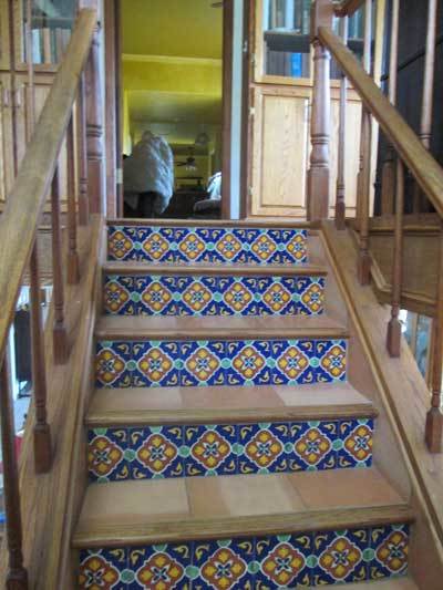

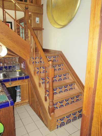

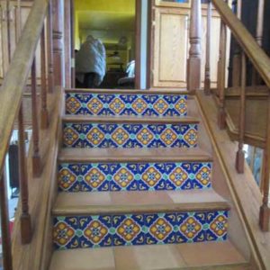

    I just redid my stairs.
    I used oak nosings, glazed tile risers, and saltillo treads. It sounds like your risers are a little expensive for what you get. Treads and risers get alot of wear and tear. Solid wood is much better.

    1. netrate | Jul 25, 2013 03:00pm | #2
      you did a very nice job there. What are Satillo treads?

    Keep in mind that anything you put on top of the treads will effectively raise the entire stair, making the bottom step long and the top step short.
    And looking at those stairs the stringers are no great shakes either.  (Were they carpeted too?)
    I'd say either replace the entire stairway or just install more carpet.
    1. netrate | Jul 25, 2013 10:59pm | #6
      thank you for the comments, it makes sense now. I am not sure what stringers are and yes there was carpeting over top of the tiles. Getting rid of both carpet and tiles.
      Should I buy some Glue stripper for all the leftover epoxy and glue on the stairs?
