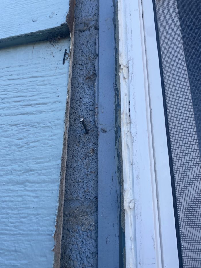

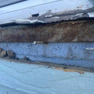

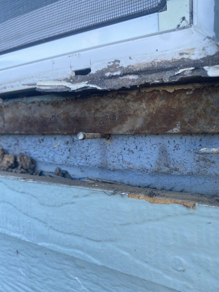

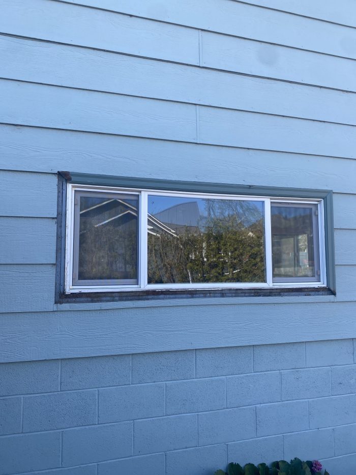

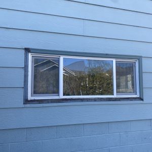

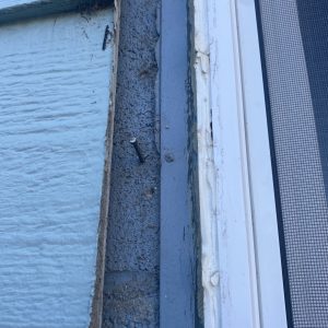

This job requires replacing trim/ siding anchored directly into cinder block wall.
How should I do this most effectively?
Adhesives? Concrete anchors? Looks as if they used nails previously.
  1. [email protected] | Apr 14, 2025 11:32pm | #1
    Personally I’d use composite trim, countersink holes for masonry screws and finish with composite plugs.
  2. olderthanyou | Apr 15, 2025 04:45pm | #2
    I’ve had problems with expanding concrete anchors in older houses, they seem to crack the concrete before they get really tight. I’d agree with the previous poster.
    1. calvin | Apr 16, 2025 10:19am | #3
      Using too big of a screw in a plastic anchor could produce a crack, though I’ve never had that happen. Metal anchors maybe.
      I’ve never come upon siding that didn’t fasten to furring on block.
    Michaelthomsan | Apr 18, 2025 03:14am | #4
    You can use concrete anchors for a solid hold, or strong construction adhesive if you want to avoid drilling. Both work well—just depends on the look and finish you’re going for!
