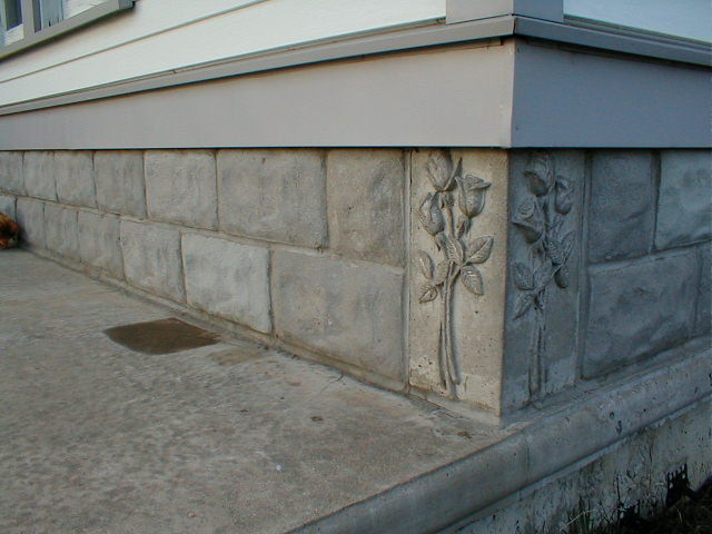

Summer kitchen foundation . I made a mold for the faces from anold block . made the faces and applied them to clean blocks while still wet . I dampend the block first for a better bond,

Fascinating! How did you make the mold? What did you use to bond the face to the block?

The mold was made of fiberglass for these blocks . I have since made up a pattern and had a castiron mold made . I laid the face up in the mold and then set the block on top,while holding it firmly ,I flipped it over tapped it and removed the mold. then cleaned up the edges. I also made faces that I applied to an ICF foundation . There I used expanded mesh and a scratch coat . I set the block faces as soon as I coated the mesh . Back buttered the block face also.
They look just like the originals I've seen. Are the flowers also applied?
The flowers are cast in a mold that I made for the corner block . The mold for the block was taken from an antique original rock face block . I had about 8 of them .
took the best of the bunch and covered it with aluminum foil and started laying up fiberglas.

How thick did you make the faces and what type of cement mix did you use when pouring the moulds?
I'm curious whether or not you could use a light weight mix of some sort and then attach it to an interior wall just like the fake stone manufacturers use. Heck, I'd rather use your "look" than what is presently being sold on the market.

Davo ' I could make you a cast iron mold cheaper than a fiberglass one . I will have to check on the cost of casting ,it has been a few years since I had the molds made.
The mix is 3:1 sand /portland or you could use a2:1 mix . I always end up with more portland any way. so it might be 2.75:1
Thickness varies but about an average of 1/2 to 3/4"
I put expanded mesh up on the wall ,scracth coat then back butter the cmu and stick it up and strike the jouint.

Davo , I got some UHMW poly today . I think it will make a better mold than FG or the cast iron . When I get my bill I'll let you know .
