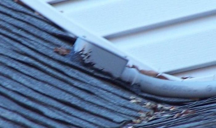

A separate contractor put a bank of solar panels on the upper roof, and the power lines from the panels go from the upper roof to the garage roof on their way to the electric meter. Where the power lines go into the garage roof, there only seems to be tar sealing the penetration. Is this true? Is this enough? Should something be shielding water from the penetration?
Yep, that is a problem. I'd give it till next winter before it starts letting water in your house. Why did it go in there?

you can have a vent jack installed over thatMike Smith Rhode Island : Design / Build / Repair / Restore
except that it should be moved away from the valley too
Yeah, even the old pitch filled boxes would be a problem that close to a valley I think.Spheramid Enterprises Architectural Woodworks

What a shoddy job.....tar is not a flashing, tar always fails!
Looks as if the conduit and ell will act as a dam to the flow of the water.
Those shingles look "not so good"....the roofer will have a dandy time redoing that penetration. Should have been run through the gable end wall or through a standard roof boot, or a flashed assembly.

solar technicians are not roofers.
Back in the seventies when a lot of solar installations got slapped atop roofs, I saw hundreds of things like that and 2-10 years later, lots of leaks.
of course, roofers are not solar technicians so a lot of solar installs got removed after that ten years when re-roofing....
Somebody has to co-ordinate between the two.
solar technicians are not roofers...Somebody has to co-ordinate between the two.
Any suggestion on what we can do to repair things at this point?
That should be removed and installed thru a wall.
I think it can be done. Some people from the solar company are coming out on Wednesday to look at the problem. Planning to insist on taking the conduit inside -- guaranteed to save a lot of problems in the long term.

This is what happened when the sub sent by the solar contractor came out to correct the problem:
Me (pointing out the conduit): You see how leaves are collecting behind the conduit already because it's laying right on the roof, and that the penetration is just tarred in? We know that's going to make water problems, so what I'd like to do is raise the conduit up by at least a few inches, add a boot, and flash it.
Sub: We don't have a boot for doing that.
Me: Well, in that case, I don't think we have any choice but to take it inside and run everything through the walls.
Sub (to his partner): Get the boot out of the truck.
Not a great way to build trust, but at least he was doing it. I had work to do, so I went back in. An hour or so later, he told me he had finished. You can see the result in the photo. He told me that he could only raise the conduit an inch above the roof.
What's your opinion? Can you tell if the boot was installed correctly? Also, I noticed cuts in the j-mold behind it. Is that OK, or is there a problem?

If that were my home that would be totally unacceptable.
I thoght you had determined that only a wall install was acceptable.

Like Pif told you this morning the boot should have been installed when the conduit was installed.
You've got a major roof problem there now.
It was a poor place to enter the roof anyway, if it even had to go thru the roof.
With some sealant applied you might be able to get by until warmer weather when the system can be shut down and a proper install done

Kind of busy today but plan to call the solar company tomorrow and tell them I gave them two chances to install the conduit correctly through the roof, as they wanted. Now it has to go through the wall.

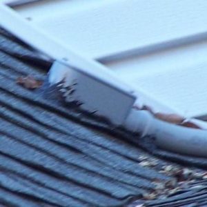

That photo does look kind of scary, doesn't it. Like a water-sucking lamprey latched onto my roof.
Gee, do I see exposed nails in that close-up poking more holes in the roof? They were supposed to fix the hole in the roof. Now he has about six more holes along with a scupper to trap water

Geez, that's bad. Bad bad.
That's what I was afraid of.
that is not acceptiable...
the boot is mushroomed and won't seal well...
it'll get worse too as time marches....
can we say recall???

In this photo you can almost see up under the J-mold to know whether he used step flashing, but the focus is so bad it tells me =nothing. Maybe you can get up and look or feel in that gap.

I don't know why you asked for a boot there. The most wrong with that is the fact it is so close to the valley and trhe way that boot is now installed has made things worse. That boot is not even made for that sort of penetration. When a boot is used, it is suppsed to be installed such that the sides of the flanges are under the shingles with those shingles cut neatly to it and only the bottom flange showing above the shingles. A gooseneck conduit comes up out of the boot and wiring is run down through with a seall at the end of the gooseneck. That way if seal fails, it is at a location where it faces down and aaay from where water can run in.
As it is, you have a 3" hole in the boot with a slice cut down for about a 2" conduit box. There is a cup facing up to COLLECT water and direct it into the house.
when a boot is installed, wiring has to be disconnected to run through the system, not cut the boot and just slip it around the pipe.
This is sad, but like I said before, I NEVER expect a solar installer to be able to do roofing work properly any more than I would expect a roofer to be able to run wiring. Occasionally you get lucky, but not this time
The question is: Now what? The people sent out by the solar company have already botched it twice (different subs). I've already paid in full. From my understanding, the solar panels are live and cannot be turned off other than by completely covering them with something dark.
Also, is this an immediate leakage problem or one that can wait till this summer, when I'll have time to deal with it myself if need be? The plate's pretty full at the moment.
