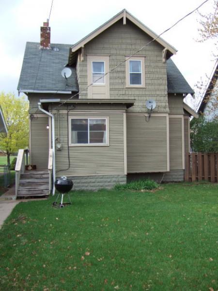

Three guys four days, tore off, dried in, reshingled, reflashed, cleaned up and cashing a check.
Possibly one more day if the side wall flashing is particularly difficult.

that is a cut -up roof

There's a lot of flashing and cutting in that roof. don't try to compare yourself to a pro roofer. It is a very athletic strenuous job.I would probably take 5-6 days now ( I an old worn out guy) but would have used three days twenty years ago.

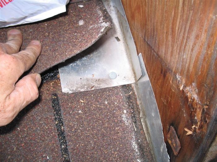

I bet you don't have any flashing "details" like these "pros" installed on my roof...
