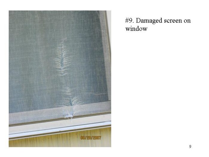

Accidents like the damaged screen, while unfortunate and avoidable, happen all the time. They need to get it fixed or deduct enough of a chunk to make it worth your while to do it yourself if you're not comfortable with them getting it done right.

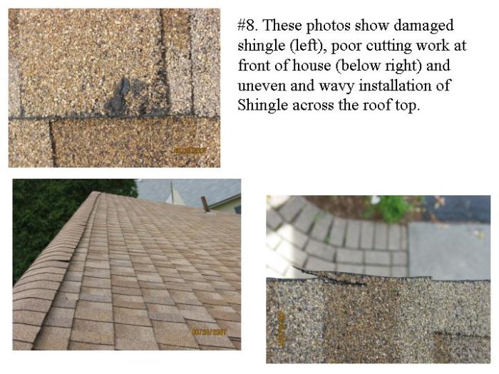

One thing I look for to "grade" the job a shingle crew has done, is how straight the shingles come into the ridge. You can tell a lot about experience and how much care is taken by that. Yours looks pretty straight.

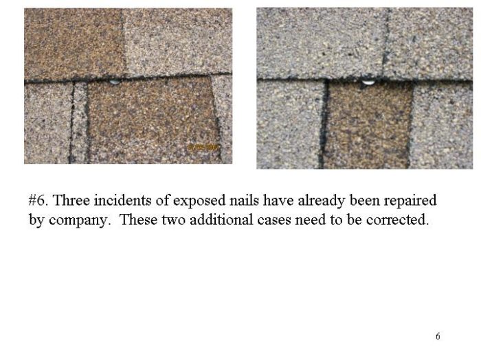

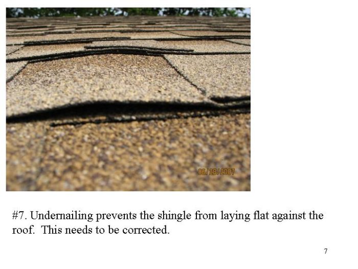

5 or 6 low nails per roof is not too bad. They need to be fixed, but not too bad.

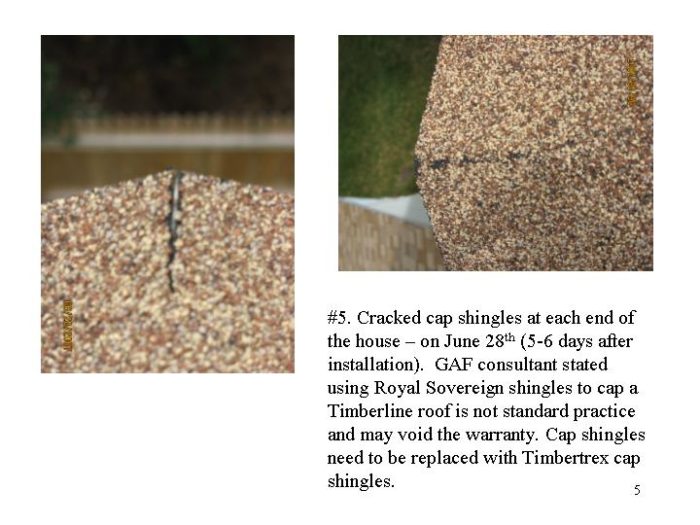

I noticed the GAF rep said the warranty "might" be voided for using the Sovereigns for ridge caps. Either it is or it isn't. He's trying to sell the ridge accessories. But, I'd hold the roofer to using the ridge accessory.

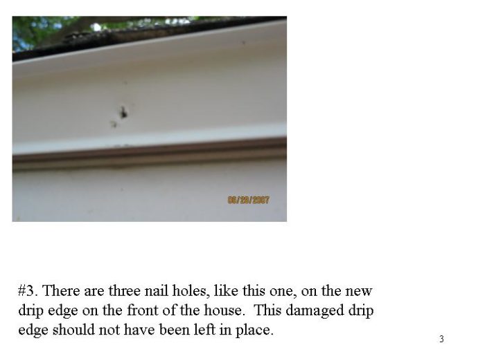

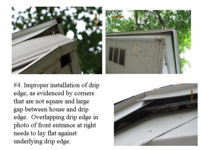

I wonder how or why the face in pic#3 got a nail hole? Think they tried to force a "pooch" out back in?

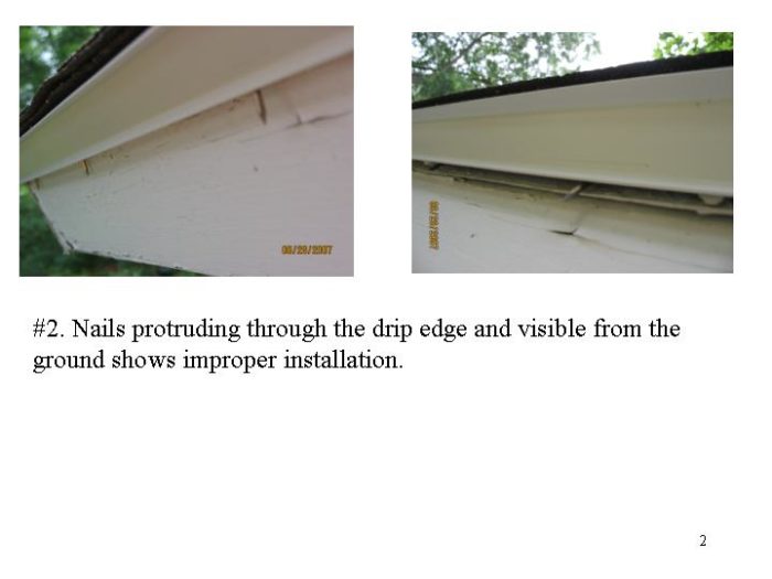

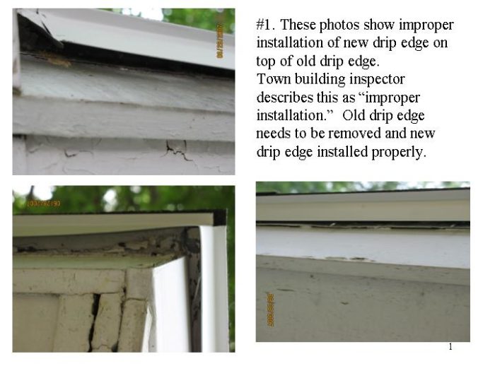

The nail holes in the face of the new drip edge are there because the new was installed on top of the old. Since the 2 drip profiles do not match, the new is 1/2 to 1 inch away from the house all around. By doing this, the roofers decreased the surface area they could use for nailing the new drip edge. Most of the new drip is nailed only to the old galvanized drip. With the reduced area for nailing, some nails began to go through the finished face of the drip. It looks to me like thay noticed it, pulled the nails out, then kept roofing.
Ok, I guessed they were nailing from the outward face.
Still, needs to be fixed.

I agree about the screen. Accidents do happen, and if this is all that happened I would'nt even be worried. I put this photo in as one more example of the "rush job" this seemed to be. Fixing the drip is our main priority. I posted what we are asking him to do to correct the job if you want to read and respond.

The most serious problem is the poor drip edge installation- since it's very unsightly and very visible from the ground. I would make that my top priority to have that fixed.
Seeyou was right on when he said the shingle coursing though not perfect is plenty good enough. Caps are not a big issue since there is double coverage there- but if it will void the warranty then they must correct it.

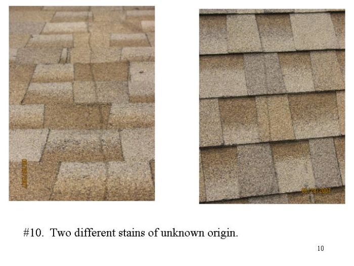

Stains look like a spilled coffee or soda and will disappear soon enough.
When I damage a screen inadvertantly I replace it or pay to have it done.

I included the photo of the screen just to add weight to our feeling that this was a rush job (Someone used the term 'hit and run' last week.). I understand that accidents happen, and have made my share myself, but the professional thing to do is fix it or pay to have it fixed.

The eave edge metal definitely needs replacement. I may have seen worse, but I really can't remember when.
But I still think that meanss they will have to replace most of the shingles to do it without leaving you a damaged roof.
The stains mean nothing.
The ridge is almost as straight as you can expect.
A few low nails mean careless work but not the end of the world.
On the ridge, I trhink it looks to me like they are onmly single ply. Heavy archies are supposed to be laid two play.
Where it is most obvious is the first one where it is cracked and the edge metal shows through. They never even used a starter ridge.
Overall, I read this job as somebody capable of doing better and thinking they know where they can get away with cheating a little. not meaning the contractor necesarily, but the insall crew.
But that means there could be other problems like lacck of underlayment, and fewer than four nails per shingle. That is somnething you can check possibly from in the attic. If they cheated the number of nails, added to the poor metal edge work, I would be asking for a complete re-roof to get it right.

Can you explain what you mean by the heavy archies need to be laid 2 ply? I know you are talking about the ridge. This is where the contractor used regular 3 tab shingles that he cut, instead of the architectural ridge caps specified by the manufacturer. There is a clear price and quality difference here, which is why I think this corner was cut. A bundle of ridge cap shingles around here cost about $35.00. The 20 year 3 tab shingles he used cost less than half that.

I'm not going to obsess about the two stains. I just took the photos to provide one more example of the lack of workmanship on this job. Same with the damaged screen.

actually---- the thing that interests me----is the stain.
I am wondering if it'a an oil stain----from somebody oiling air guns on the roof top----- if so, might be a problem down the road
-- but- probably pop or coffee
Once I stained a roof with wasp spray.---------hmmmmmmm.
stephen
If its a roof I been on....probably blood. LOL
I was wondering how you get the blood stains off the guitars and instruments you make. I KNOW you get some on them.
Hydrogen Peroxide. Poof! its gone.
I'll have to remember that one.
I'm assuming the stain is gatorade or coffee, but oil is certainly a possibility.

Install new drip edge correctly (see exhibits #1-#4).<!----><!---->

Install Timbertrex Ridge and Hip shingles, as specified by the Timberline Manufacturer GAF. (GAF states that using Royal Sovereign shingles on a Timberline Architectural roof is neither an approved practice nor one covered by the GAF warrantee.)<!----><!---->
Repair additional defects illustrated in accompanying photographs. Specifically, replace cracked or torn shingles (see exhibit #5); nails protruding below the shingle course (see exhibit #6); correct undernailing as necessary (see exhibit #7); poor cutting and shingle damage as shown in exhibit #8.
