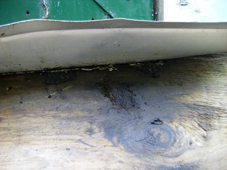

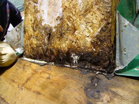

HO had mentioned, just after signing the contract to re-roof his chalet, that they’d had some ‘small leaks’ around the woodstove chimney during heavy rain, so would I check it out when I was doing that side of the roof. So when we stripped the shingles at the base of the chimney chase, I pried back the flashing and took a good look.
It was like reading a mystery novel, up there on the roof–every little clue led to another.

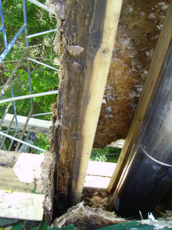

After seeing this, I was almost afraid to pull the siding on the north face…

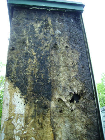

Those holes in the beaver barf were where it stuck to the rusted siding nails and came apart in clumps as we pulled the cedar shiplaps.
Under the sheathing….
Sigh….
