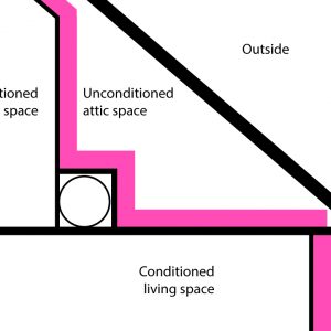

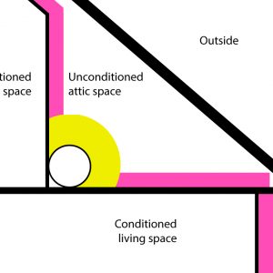

While it’s far from ideal, I have to route a duct through an unconditioned kneewall attic space for about 4 feet. If I frame and drywall around it, the duct stays inside the building envelope (image 2), but with 2 exterior walls. Couldn’t I achieve just as good results by spray foaming it (image 1)? Is the only disadvantage the cost?

    Thanks for the replies. This is climate zone 6 (southern Ontario), so very cold winters and some hot summer months too. It's an existing house, so the kneewall and the attic floor of the kneewall is already well insulated with fiberglass (walls) and blown in cellulose (floor) to R-value 60.
    There will be one take-off a small room register before it ends at a register.
    There is an existing vapor barrier in the wall assembly. For the duct, if I mastic seal and then spray foam the duct directly, I assume that would be good enough as a vapor barrier?
    unclemike42 | May 28, 2021 07:09am | #4
    Since you have to cut through the vapor barrier to put the registers in, make sure to seal around them well.
    Mastic should be fine to seal up the holes.
    I would pull the existing insulation back, install/seal the pipe, and replace/supplement the insulation over, focusing on the attic-facing side.
    Spray foam could work ok, but more fiberglass would work fine too. You would want enough spray foam to provide similar R value.
  5. Ben_ten | May 28, 2021 10:42am | #5
    Great, thanks for your advice! I will probably end up with a spray foam coat followed by cellulose/fiberglass on top of the duct.
