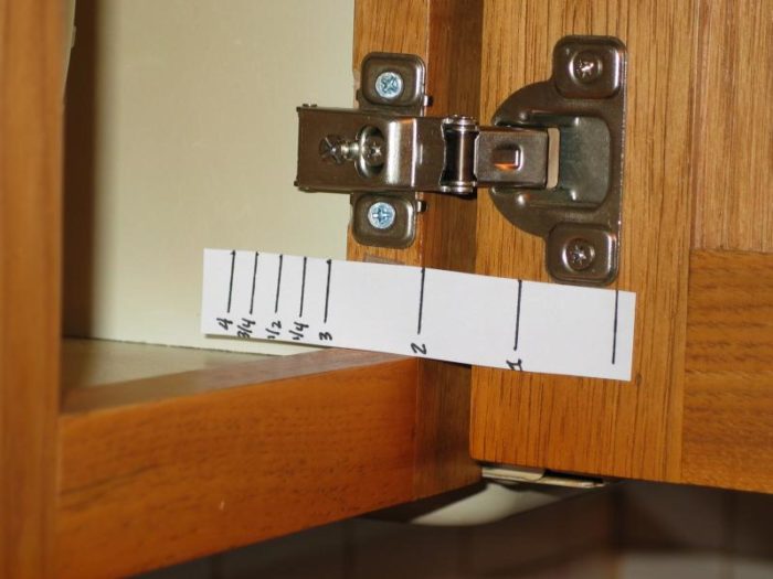

I’m in need of a Salice cabinet door hinge due to a broken spring. Salice America has been no help (very unfriendly web site) as well as other suppliers I’ve found on the Web. It doesn’t show up in any online catalogs. It’s approximately 3 3/8″ long, 110 degrees opening, and has an unusual design. See below. Anybody recognize it or know of a good source?

swap em out with Blum or Grass hinges..standard cup hinge with FF wrap.

Try cabinetparts.com. A search of their site turned up several hits for Salice hinges.

Salice is a clone for "most" hinge borings as "Blum" brand hinges. Try letting us know where your located, so as to help you with getting a replacement.
Your phgotos are too big/unreadable to get a good idea od what you have. If you can get a good "downsized" file, I might be able to help. I have quite a few salice and blumm hinges laying around.

Sorry, I wasn't aware how large that would be. Another picture, only smaller. Located in Western Wisconsin.
I don't have that type, but Blum Compact 32 hinges should/probably work in the same pattern. Biggest thing you need to know is the actual drilling distance from the cup hole to the edge of the door. This is known as the "DBE"and it is some where from 3-6mm.
The next is the amount that the door overlays the frame.
