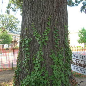

    Matt | Jul 05, 2008 09:51pm | #7
    this is mostly a bump but...
    Here is a little update and a few pics.
    I'm trying to get the dirt away from the tree that was placed there.
    Got a laborer from a labor pool to remove by hand the new dirt....  that didn't work out too well... In 7 hrs he probably removed 5 full wheelbarrows of dirt - actually about 20 wheelbarrows about 1/4 full...  At that rate it was gonna take about 4 or 5 days....
    Called a guy I know who works for a landscaper - Guadeloupe (sp?).  He is working on it right now.  He says he can get it mostly, if not all done  in 5 hrs.  After that I'll get my landscaper to come out and grade the other areas of the lot (again) so water won't sit around the tree.
    Called the city arborist to come take a look.  No return call as of yet.  I'm paranoid the person is gonna come out and then decide I need to be fined....
    The thing is that the city requires the right of way for all new construction homes to be graded at a 1/4" per foot (up-slope) coming up from the curb.  The right of way is 9.5' wide (or close to it) but I guess this just isn't gonna happen.  The dirt I had placed had brought the grade up about 4 to 6" which was only about 1/2 of what was needed to satisfy that city requirement...
    Anyway, attached are a few pics of the tree.  I forgot to get a close up that shows the wilting of the leaves...

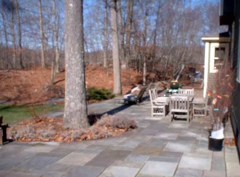

      Mongo | Jul 06, 2008 01:07am | #8
      I had location restrictions when building my house, but I wanted to save the tree in the photo below. The grading around the tree was changed a bit, and the excavator did ding the trunk a couple of times during construction.
      When I put the patio in, I dug down, then poured a concrete footing around the perimeter of the patio, about 12" wide and 8" to 12" high.
      On the subsoil inside the patio I set several runs of perforated 4" septic pipe, then filled with 8" to 12" of stondust, then dry set the 2" bluestone on top of that.
      So the tree was abused.
      Had a little scare the next couple of years, a little weakness at the crown, what I called a little crown die back. Then the tree took off. Still going strong, a built back in '95.
      My tree is a red oak. In general, for red vs white oak...if the leaf fingers are pointed, it's a red oak, if the fingers are rounded, it's a white oak.
      Edited to reduce size of picture.
      Edited 7/5/2008 11:36 pm ET by Mongo

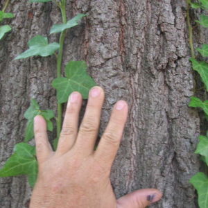

        Matt | Jul 06, 2008 04:30am | #11
        Yea - I got a red one in my front hard that I gave little reverence to.  Grading, etc... Going strong after 9 yrs....
        I had no idea a large oak could be that fragile... (on the current project)
        It's amazing how many different kinds of Oaks there are.  Again, I'll try and get some close-ups of the foliage and bark.
        Edited 7/5/2008 9:41 pm ET by Matt

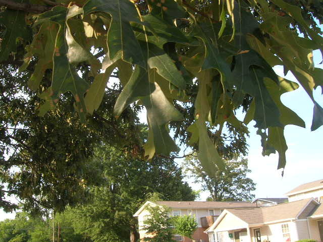

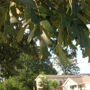

        Matt | Jul 06, 2008 08:59pm | #13
        Here are a few more pics that I was hoping would show the wilting - didn't come out too good....  Still forgot to take a pic of the bark...  I think you are right.  Not a red oak - no pointed ends on leaves....  Or - looking at my Audubon Society Field Guide to North American Trees it could be a southern red oak...
        $400 in labor and I've got the extra dirt from around the tree in maybe a 25' diameter circle.  I feel like maybe I'm fighting a loosing battle though...
        Edited 7/6/2008 2:01 pm ET by Matt
