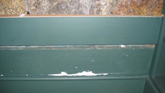

The drywall is not in direct contact with the exterior (granite block) wall. Removing the existing drywall to replace it with greenboard would be a huge undertaking due to the heating system setup.
To be quite candid, I am looking for a 'quick fix', something that would make the drywall impervious to moisture; a sealer #Bin?# of sorts.

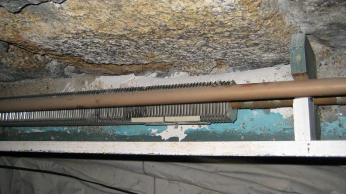

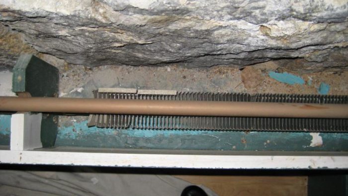

Let me try to describe it better. This short wall is about 16" high and is half covered by a wide baseboard. That leaves about 8" of drywall exposed. Above that is the fintube, fronted by a piece of 1x6 and covered by a piece of 1x8, a half of box if you will. There is a gap between the 1x6 and the drywall for air flow. There is also a gap between the 1x8 and the granite for air (heat) flow.
The problem area is that vertical 8" of drywall and the horizontal section that sits under the fintube. Neither of which is in direct contact with the exterior wall.

Some pictures would help us understand the situation.
Ok, here are some pictures...
Post a pic.
