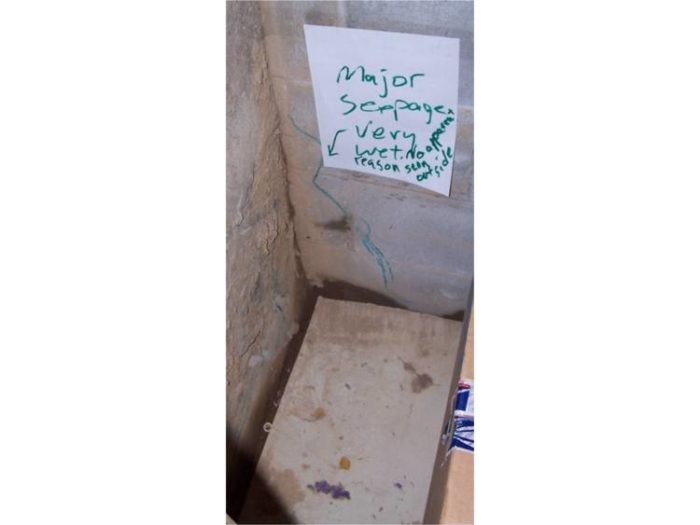

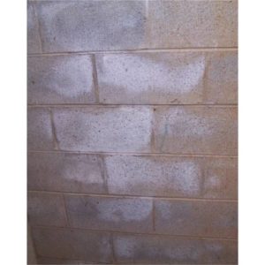

We have what look like some problems in the basement too. Please let me know what you see in these photos, and if anything should be done about them. Some background may help:
We had a very wet month, and once the electric light circuit was turned on in the basement, I noticed a lot of spots where water had been seeping. The photos were taken the next day, after a cold front came in and everything froze outside, which seemed to let the basement dry out some, but you can still see white powder where the seepage had been. This basement has only been around since September.
There’s also an external basement staircase with the same problem, but it froze on both sides.

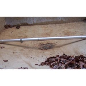

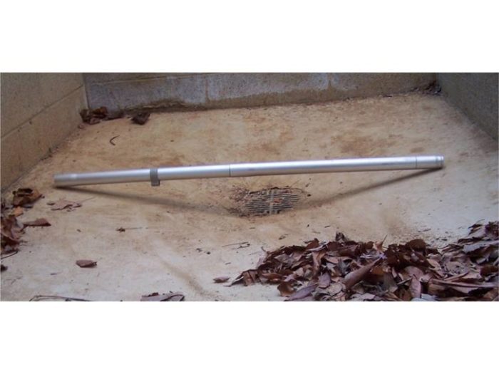

Also, the drain for the basement seems awful deep.
do you know what or how the backfill was done???
where are the gutter down spouts relative to the seepage locations???
what is yur soil composistion???
what type of soil do you have???

water proofing is too low on the wall... dig out the back fill and finish the water proofing...
water isn't draining away from the building... grade/slope the surrounding area away from the structure..
way too much soil and not enough rock... clay will hold the water to the building...
water proofing is too low on the wall... way too much soil and not enough rock... clay will hold the water to the building...
Sounds like some digging and rock are in order...
maybe 6 and half feet of dirt less...
Looks like you have a clay soil. How much gravel did they backfill with? Obviously not enough, the water is standing next to the foundation, the discoloration is probably the color of the soil. See a connection?
Without gravel the block wall will continue to soak up water and seep inside.
The foundation needs to dug up and backfilled with gravel to 12" of final grade, sock tile in the bottom. And while the walls are exposed a thick coat of foundation coating needs to be applied.
The drain is all wrong as well, too much slope. See the leaves sitting there? That will continue to happen, with that much slope the water runs away and leaves the solids in place. Not all bad, but someone is going to break their ankle around that thing.
That's what I think. Is it just a matter of pouring more concrete over what is there and raising the drain?
How is the drain attached?
Is it a glue in drain?
I would pull the grill cover off the drain and figure out a way to extend the drain to the desired height. PVC you go and find a fitting that you can use and a new glue on drain.
You mnay have to cut around the outside of the drain to get a coupler on it, or find something that fits the ID snugly, almost like a street elbow.
You may be able to get a drain thats tall enough to fit your new height as well, thats what I'd check into first. Go to a real plumbing supply house and tell them what you want to do and they should help with what you need.
Bonding agent will be needed between the old and new concrete. Thats very important. If not used the patch will most likely crumble. Woods favorite carpenter
How is the drain attached? Is it a glue in drain? It is an 6" round non-adjustable EOL Sand Interceptor in SCH20/ABS
Pulled off the drain. I'll talk with the contractor about getting the fitting and also take care of the new concrete, using bonding agent. Gonna keep an eye on what he does.

One of the benefits is not having porous mortar joints every 8" vertically and 16" horizontally.
Poured walls are more apt to be more waterproof given the same exterior treatment==== or lack thereof.
Poured walls are more apt to be more waterproof given the same exterior treatment.

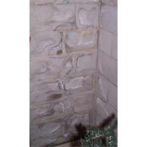

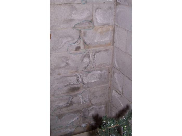

Holy Honeysuckle, Hannah!I've never seen it exploding like that before in new work. There has to be a lot of water to be making that much staining, efflorescence and deterioration.How hard of a freeze have you had that far south anyways?
or more likely, several freeze/thaw cycles. That does more damage than one hard freeze all winter.
With the exception of the cost of the flooring, it seems that a lot of what problems you have could be fixed with mostly labor cost and little materials dollars, so he could conceivably do this right and not end up broke...
...I've never seen it exploding like that before in new work. There has to be a lot of water to be making that much staining, efflorescence and deterioration.
Given what you see happening with that exterior basement stairwell wall, do you still think that this could be fixed mainly through labor and at relatively low cost?
Yup. On a daily basis.

It almost looks like there are some freshly drilled holes in that wall. Did you have somebody do that testing for water of feeling for whether the cores were filled or full of ice? If so what found?
Those holes are from the mold for pouring the concrete for the stairs.
Should I add some holes myself to reduce the damage, or would that place liability for the walls on me? Should I have the contractor do it instead? Right away or can it wait, or is it already too late?
Or are you saying that I should have someone come out and do some kind of test? If so, what kind of person and how could I find them?
Thank you!
OK, I see that answer. I thought the wall was block and not formed. If it was a poured wall with forms, then you probably have honeycomb voids at the exterior face of the wall surface. Digging is the only way to know what the deal is there.
Your first impression was right: the wall is block; only the stairs themselves, the base, and the basement floor are poured.

both showed some seepage as you showed (probably your seepage is a bit more than mine, but not much more)
My conclusion in all this was that I did all that I could reasonably do and that I would have to live with some seepage.
I noticed that the ground was poorly graded outside one of the seepage areas and another seepage area had a drain spout right next to it. A regrading and a 10' downspout extension should help a lot.
These are relatively easy fixes and I'm going to see how much they improve the situation before we dig out all of the clay down to the gravel level.
The tar waterproofing definitely didn't come up high enough though. I can tell exactly where it stops by a horizantal seepage line. Gotta be fixed.

The white powder you observed is probably efflurescence. The water carries dissolved salts to the surface and abandons them when it evaporates.
