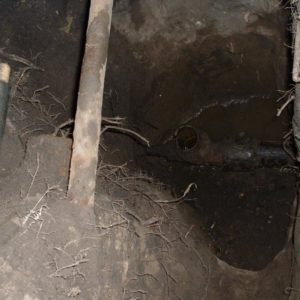

I had to remove some cast iron DWV pipe in order to get a snake in and clean out the line to the main line. That’s done and now I’m having trouble visualizing how I can replace some of the pieces–presumably with PVC.
The basic problem: I need/want to replace what I THINK is a 1/4 bend with high heel inlet (4x4x2) and haven’t found that available in PVC. ( I found low heel but not high.)
More details: The picture shows at the bottom of the hole, a 4 inch sewer line heading for the main (to the right in pic). A 2 inch line (on left in pic), from kitchen sink dumps into that 4 inch. The 4 inch piece I cut out went vertically from there to the 4 inch pipe cut off in the upper left of pic. Since the 2 inch line is offset a couple (?) inches from the center line of the 4 inch, I can’t see how any of the standard PVC fittings I’ve found would allow me to hook these up with appropriate drainage.
I’ll also note that the 4 inch fitting and 2 inch pipe all rotate fairly easily around the 4 inch pipe axis so I presume I need to replace all of that, rather than try to remove the rest of the cut-off vertical piece, and re-use it?
I appreciate any suggestions you may have!

    OK if I understand you corectly, you are replacing the 4x2x4 cast iron fitting in the pic.
    If that is the case, you will need a 4" combo & a 4x2 reducer, but before I run off on some tangent I want to be sure that is what you're doing.

      You're correct about what I'm doing.The problem is the 4x2 reducers I've found have the 2" offset by maybe 3 inches(?), while the offset I need is far less. Hope that makes sense.Thanks.

        OK see if this makes sense.
        Install a new 4" combo as far down stream on the pipe as possible, then using street 22.5 bends (male x female) offset the 2" to line up to the center of the 4" pipe then use a 4x2 fitting rdeucer in the 4" combo.“When politicians and journalists declare that the science of global warming is settled, they show a regrettable ignorance about how science works.” Nigel Calder,  editor of New Scientist

          It makes sense, and I had looked at 22.5s, and 45s, at the hardware store but couldn't visualize how to get such a small 'offset'. (Spacial relationships are not my forte.) I'll go back and play with them at the store. <g>Another question: I've dug out the 2" line some more and found it to be black plastic. Presumably ABS?? I've got it in the back of my mind that ABS is not supposed to be, or can't be, attached to PVC? No code here, but I do want it to work, and last.Thanks again.
          1. plumbbill | Apr 13, 2007 02:27pm | #6
            Correct, ABS does not attach to PVC. You will need to use a "no-hub" style coupling, which is the same connection that you would have to use if it was cast iron too.“When politicians and journalists declare that the science of global warming is settled, they show a regrettable ignorance about how science works.” Nigel Calder,  editor of New Scientist
