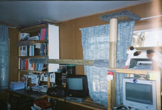

  6. renosteinke | Aug 08, 2007 03:14am | #28
    Hate to disappoint you ....
    I have a similar arrangement. Here's a pic:
    http://i143.photobucket.com/albums/r138/renosteinke/550desk.jpg
    Here's what I've learned from this project:
    1) I'd raise the first shelf a couple inches higher than the 18" it is now at;
    2) Only the lower two shelves are of any use; the top shelf is not within reach, and the small gap at the very top is useless;
    3) At a level perhaps 8" above the desk, I'd add a trough, or gutter, for placing small stuff; and,
    4) Some means of supporting materials on the shelves along the length of the shelf is needed.
    Edited 8/7/2007 8:17 pm ET by renosteinke

      1. renosteinke | Aug 08, 2007 05:41am | #32
        True enough .... I just posted my pic, and dimensions, because you are doing something I already have done a lot of experimenting with. While my efforts may not be fine furniture (bless the folks at Simpson Strong-Tie!)... they are very user-friendly, and are rock solid. I just thought a pic of one actually built would trump an artist's sketch. If you have a flat screen, then it is possible to put a monitor on a 24" desk. Best of luck in your project.
        1. Ragnar17 | Aug 08, 2007 07:04am | #33
          Are those cat perches in the picture?
          1. renosteinke | Aug 08, 2007 05:03pm | #34
            Busted! Yes, that's 'cat furniture' added to the 'people stuff.' For a view of the entire arrangement, here's a larger pic. (Forgive the clutter):http://i143.photobucket.com/albums/r138/renosteinke/550New20cat20tree.jpg
          2. Ragnar17 | Aug 08, 2007 07:50pm | #35
            So the big question is: with the climbing facilities, do the cats still have the urge to lay right on your keyboard when you're trying to use the computer?  ;)
            My cat would especially like the bridge portion of what you've got there.  We used to have a long 2x4 from our porch to a pergola for him.  We refered to it as the "bridge of death".  Unfortunately for him, it all got torn up in a remodel.
            One last question: is the calico in the photo real, or is it a stuffed toy?  I've never seen a calico with such clean markings.
          3. renosteinke | Aug 08, 2007 09:53pm | #36
            I never meant to hijack this thread :) Cats will forever love to use computers ... let's face it, they love anything with a mouse! I actually do have pics of the components, with cats in every possible location ... but none of those pics show the entire arrangement. I have a real 'white' calico, and a flame-point Siamese. Yet, the cat in the pic is fake. Not to feel bad; this fake is done well enough that even real cats are fooled at first. It also has a pretty strong resemblance to my calico- especially as her colors have come out over the years. The 'bridge' is made from a 4" "peeler core". I have found that to be much better than cardboard tubes for longer lengths. Some areas are bare, or wrapped with sisal, as well as the carpet you see. The pieces are anchored using "2 hole straps" intended for electrical conduit. (4" for bare wood, 5" for wrapped sections).
