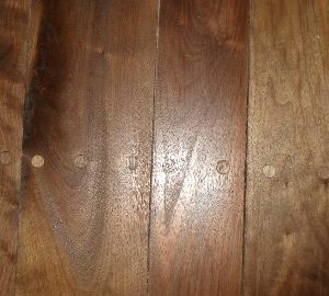

frenchy | Posted in Photo Gallery on March 4, 2007 11:31am
HERE ARE SOME CLOSE UPS OF THE FLOOR, I SUPPOSE I SHOULD HAVE DUSTED IT BUT WHAT THE HECK!
  1. Piffin | Mar 05, 2007 01:43am | #1
    Shelac on walnut, right? Not every body has caught the mosquito spit floor finish recommendations, you know.

      Frenchy's got a good idea, but I don't think shellac is durable enough to be used alone on a floor.  The shellac brings out the grain and figure in the wood, certainly.  I've got soft maple in my house, of which certain parts (stair treads and landings, and some random pieces) are curly, and they jump right out at you with shellac.  It's just as good as oil in bringing out figure.
      I'm trying to finish the floors in the house in the next couple of weeks, waiting for a bit of warmer weather to allow some gaps to close up.  I've got several gallons of Parks Universal Sealer, which is a basic 2-lb dewaxed shellac, which will go down first, followed by Minwax water-based floor poly.  1 gloss, 1 satin topcoat.  I can't imagine a better floor finish that takes less time to work with.  Two coats of shellac and a coat of poly is one long day's work, and the final coat goes on the next day and then we let it sit for a couple of days to cure.

            Shellac under the poly does a couple things (at least that I can see):  it pops the grain and figure, much more than if you just used poly alone.  Some people don't like that on a floor - I do.  Anyway.  It also acts as a sealer, lessening absorption of the initial poly coat and generally allowing a smoother surface.  You can probably get by with one less coat of poly if used over shellac.  Please note - have to use the dewaxed shellac, commonly found as Bullseye/Zinsser Seal Coat, or Parks Universal Sealer (same stuff, Parks is owned by Zinsser and it is exactly the same product).  Otherwise if you use the regular Zinsser 3-lb cut 'clear' or 'amber' shellac, the water based poly will not adhere very well, if at all.   I have used the SealCoat on every exposed piece of wood in the house except for the timber frame itself (which is unfinished) and in several cases (ceilings) it is the only finish.  Doors, windows, stair rails and treads, all get wb poly over the shellac.  I don't use stain or dyes, prefer to leave the wood 100% natural color.

      2. frenchy | Mar 06, 2007 04:00am | #11
        JonE
        Not Durable?
          Did you see the gouge made by my 150 pound New Foundland?  Shellac holds perfectly, wood gouged!
         I've been walking across that floor in my street shoes for 6 months so has everybody in my family.
         I've spilt plenty of water on that finish, but since I quickly wipe it up no damage has resulted..
          If something happens to most finishes how soon would you have it repaired?  With Shellac it could be repaired litterly in minutes..
          Every other finish requires sanding and waiting long periods of time..
         By the way Poly's are softer than shellac.. test it yourself and see!
      3. frenchy | Mar 06, 2007 04:08am | #12
        Oops, I posted the pictures of the gouge over at Knots, so I'll put it here as well.
