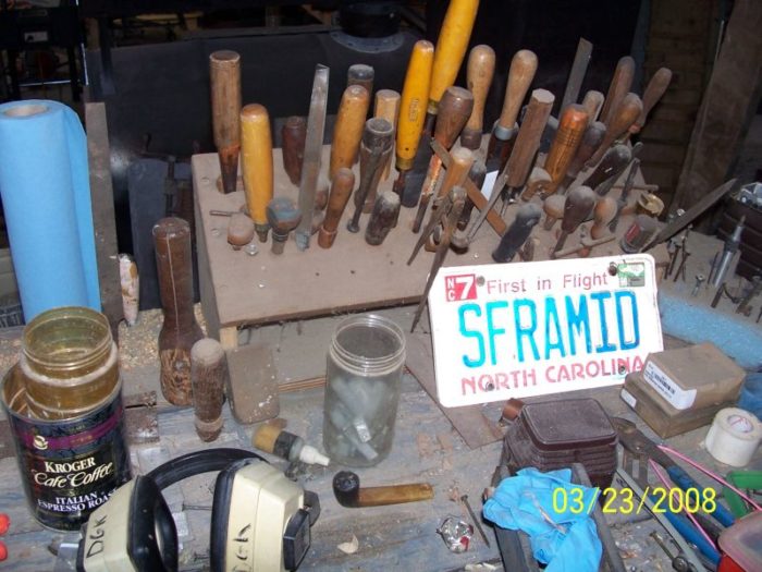

That said, if it is handleless I have a series of holes in the back of a workbench..insert by the tang, so the profile is visable. Can't see it or find it, you'll never use it.
If they are handled, I have a 1x8 board mounted at an angle, like about 38 degrees..just two uprights with the board spanning them..screwd together like a small bench with a slanted seat.
I place a slew of various sized holes in that , both plumb and perp. to the slanted face..chisels, files, screwdrivers , tapered reamers, nut drivers..all that I use frequently live in this "Handle farm" as my wife calls it. It is not attached to the bench and is portable , altho a bit tipsy . I have memorized the placement and handle configs so that I can just reach over and get what I need with out searching, the chisels stay up off the bench top by being in the highest back row, and shorter drivers and such can be interspersed..I did have to make a SLOT for 1.25 / 1.5 wide chisels, cuz the handle would not hold it up out of such a large hole diameter.
Maybe I can get ya pic in few..my bench is buried as I am asembling a 9' tall, by 5' wide frame and panel bookcase in a shop room of 14'x16'..not too roomy at the moment.

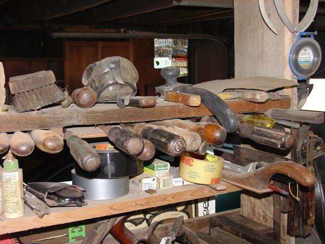

In the woodshop, I've got a set of shelves that I started several years ago, and I've spaced a board under a couple of shelves to hold 'flat' tools - screwdrivers and chisels and knifes and such -
wanted to build a new set of shelves like a hanging toolbox, but I've run out of time this cold season - It'll have to wait till next year -"there's enough for everyone"

Here's my "system". I have a few larger models hanging on nails.
Here ya go..sorry about the mess..LOL
If my bench is too clean, everybody sees it and says " So, uh, not too busy huh?"
Front,,,,,View Image
From the back..I think you can see the back panel of the bookcase..way back there by the stairs.
"Success is not spontaneous combustion, you have to set yourself on Fire"
hmm, whats that small object/pipe to the right of the hearing protectors?
Don't be a dope!
The license plate says" first in flight" Thats the launch pad !!!
That too! Ever toke on walnut dust? Yum..cough..LOLSpheramid Enterprises Architectural Woodworks
I haven't partaked in close to 20 years.
i used to consume mass quantitys
Oh yeah..same here, then it got, like, expensive..hadda quit.Spheramid Enterprises Architectural Woodworks
In the Native American tradition I share the Peace pipe with my soon to be Object D'art. My shop space is a creative sanctuary of contemplative serenity, not a screaming production of dust and chaos. (G)
And mostly, that pipe is full of some kinda tobacco. But it had a hell of a former life as a resin clogged buzz maker..it still has stains in the stone..I made it out of soapstone back round '76 or so.Spheramid Enterprises Architectural Woodworks

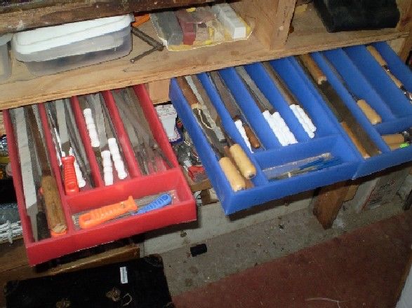

I use a half dozen plastic silverware trays. I found some large ones at a dollar store. They are not the brittle plastic but sort of rubberized. They sit on a shelf under one of my workbenches. I cobbled some guides for them and used cord for pulls. A screw through the plywood from underneath keeps them from pulling out. They are protected from impact and dust/grim, and nicely sorted.
very good, Lee! you just might possibly have more files than I - but it's close - might you tell the story of how you ended up with so many? your system looks good - what's the odds that my local dollar store has trays like that? - real slim, I'm betting - thanks - "there's enough for everyone"
Wife just told me that I got the trays from Odd Lots or Big Lots, not a dollar store.

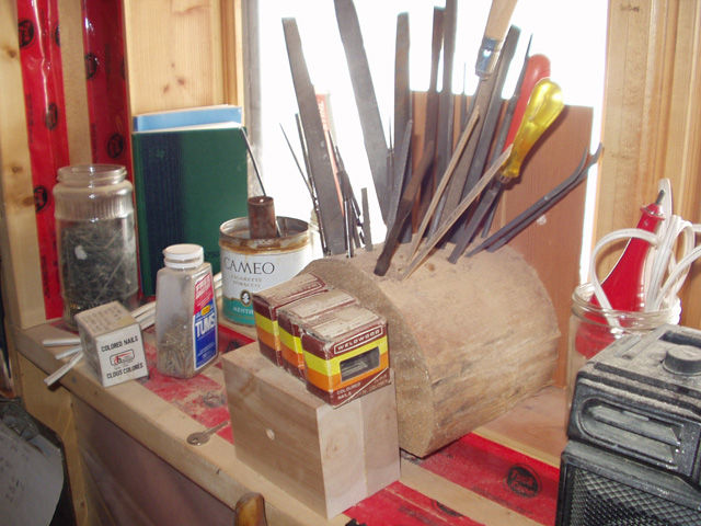

I keep mine in a few recycled tin cans which I have filled with various diameter pieces of scap PVC conduit. They used to call me dirt cheap - now they call me environmentally sensitive.
Kind of a vertical round pigeon hole system.
The PVC is soft enough that it will not hurt the files and it keeps them from banging into each other.

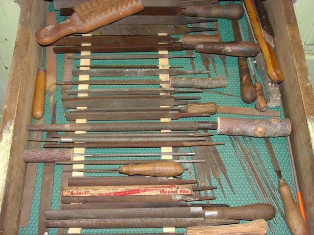

OK - done - 'good enough for who it's for' -
thanks all -
View Image"there's enough for everyone"
Now what do you do with all the junk that was in that drawer?
well, that was the file drawer - I threw out about half the files, gather in the various files that were residing in various odd locations, lined the drawer with mall-wart yoga mat, kerfed some poplar 1X1, and wal-la! there ya go - cleaning shop - organizing - it's just wonderful - "there's enough for everyone"
