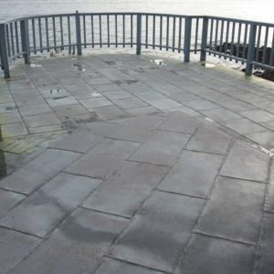

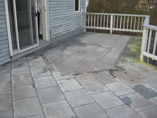

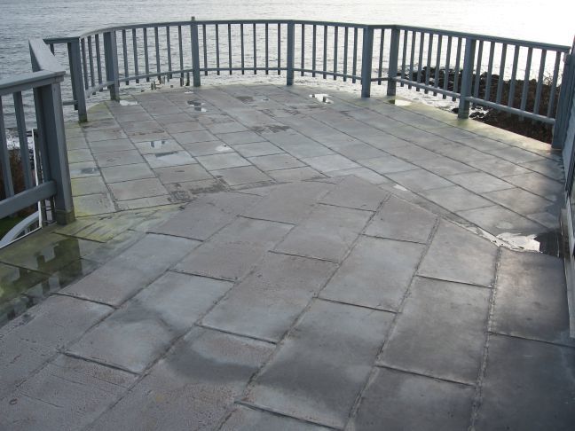

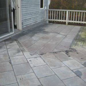

Leaks. The house was built in 1988, and the leaded copper decking is original. I have repaired several places inside directly under the exterior wall where the deck meets the exterior wall. I’ve taken off several courses of claps as well as the storm slider (a large version of a triple-track storm window) and counter flashed. There was no indication of leakage under the slider itself. The copper only extended up the side wall an inch at the least, maybe two at the most. I’ve about run out of ideas.
The owner is pretty tired of the decks (there are two of these, both leak) and their restrictions – no high heels, cleats, anything that could puncture the copper – and would like them replaced.
I don’t do much roofing, so I declined to touch the replacement of the decking itself. He found someone who has done work for him in the past, and that individual suggested putting a rubber membrane down over the copper, which doesn’t sound right.
What would you do to this, given no restrictions?

If you look at the pics, there seems to be little advanced planning/layout, though I could be mistaken; there are maybe four 'patches' of sheets, I have to admit, though, the first time I noticed the pathwork is when I was looking at the pics.

EPDM over CUs seams would be OK.EPDM over my guys seams would do fine.But the seams I see in those photos are in some places standing up a quarter of an inch, right? And some of the soldering is so poor that there are sharp spurs you would not want to drag you knuckles over, right?That is what I mean - thaat the seams would abrade the rubber from bottom side up. Maybe you could re-heat the solder and work it down flat with a peen hammer and then be able to run over it with the rubber roofing. Recovery board is something lioke a cross between homasote and sheetrock, made to handle small mounts of moisture, and with integrity enough to fasten down. It then provides a nice smooth substrate to glue the EPDM to. The smoother the base under a rubber membrane, the longer it will last, all else being equal.
I'm not certain that the leak is at the wall, I can only say that the water is dripping on the ceiling drywall at that point. I don't know what's under the copper. To isolate the wall and try to prevent further leakage without soldering, I used 6 inch bituminous self-stick flashing and lapped over the copper, sealing the flashing to the sheathing. I looked at it recently and it appears intact. Leakage has begun in a different area under the same wall (to the right of the slider, from outside).

I'm not sure HOW yourepaired these at teh wall junction, but the flashing should have extended up the wall sheathing at least four or five inches and in some places eight inches. that coast must have enough wind to call for eight, instead of the one or two that you have.
If all the leaks are at the wall, the only thing needed is to finish the job by taking up siding and having more wall flashing soldered on there.
If he wants to be done with it, I would use EPDM rubber with separation board over the copper because those seams will certainly abrade it from underneath if adhered directly.
If he wants to wear his high heels, he'll just have to get another deck built over the rubber. Walkmat pads or IPE`
Alll that green staining tells me that this does not drain well, so there is another leak or three waiting to happen where it puddles water anyway, so I would be inclined to use the EPDM rubber.
BTW, tell him that his riling does not satisfy code either, you have to take it down to re-roof anyhow.
