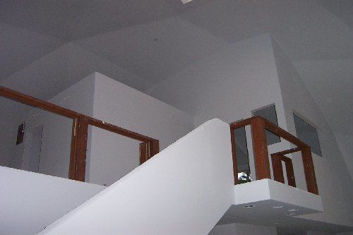

I'm just finishing a 50' geodesic...it's discussed in thread 21141.1.
Pretty easy building to erect and exceptionally strong. I'll email you any info you want that is too lengthy to post here.

I know what you mean about the accoustics! Before we got the interior walls in, the sound was so bad that it was actually hard for two people to have a conversation if two others were visiting on the other side of the shell. Interior walls and insulation pretty well took care of all that.

What I've learned from the various projects is that there are two aspects to noise: loudness and echo. Most domes are built with a more open floorplan. The openness leads to a general increase in noise be/c there are fewer walls and other barriers to absorb it. I've been in a dome that was cut into little rooms, and it had no noise issues. Likewise, I spent time in a frame house with an open floorplan, and it was just as noisy as most domes I've been in. But the type of noise was different. In a dome, the curves focus sound to the center, so the noise can echo. In a non-sphere, there's seldom an echo, but there's more discord. The sound isn't focused, as with an echo, but it's just as loud.
Not a scientific analysis; just what I've observed.
