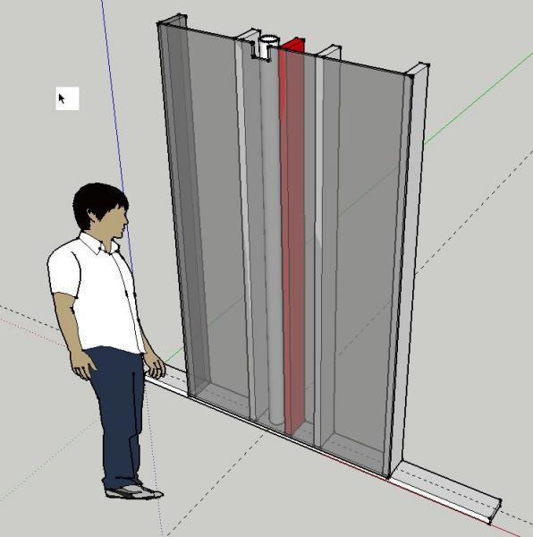

A guy I know is building a new house, and has plumbed it all, and now, after it is all in, no gypboard yet, he is wondering about how to make the drains quiet. We toss around some ideas about wrapping the 3″ PVC lines with various kinds of stuff, spray foaming them, etc., and then come upon using sand. So basically, wherever there is a drain stack coming down inside a wall cavity, you use lumber or whatever, so as to make a smaller cavity for the pipe than a full stud bay (if you can) and then fill that cavity with dry sand as you go up with your second side of gyprock. Chop out a piece of rock up at the top so as to get that sand fill up there into most of the cavity, then patch and mud the hole. I know, he shoulda used cast iron, but hey, why won’t this work?

As I believe I said in the OP, if the sand fill deal gets done, there will be extra wood fixed into the bay so that the cavity size for a stack is no more than 6" wide.
I calculate the total fill in such a stack to be around 1.2 cubic feet, or at a density of 100 pounds per cubic foot (this from a web search, dry sand), that stack of sand will weight about 120 pounds.
