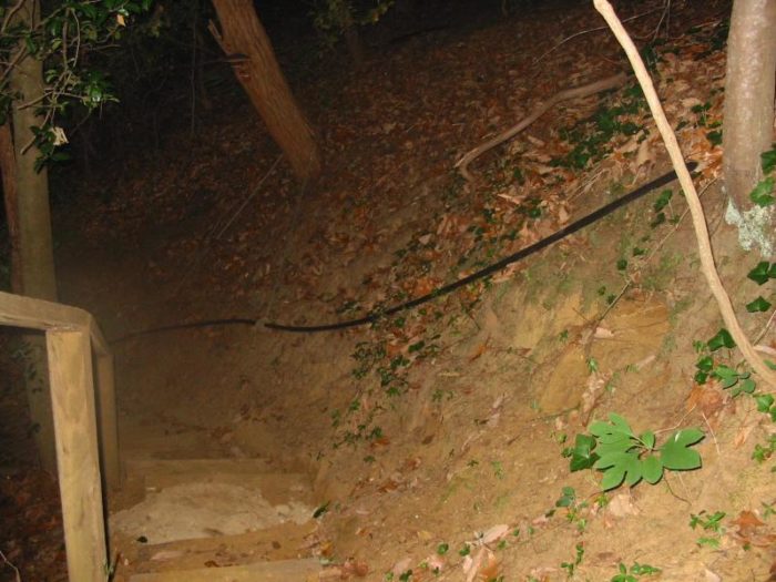

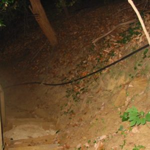

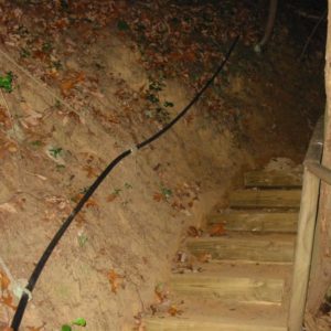

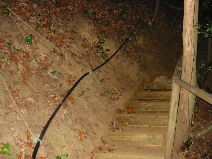

At my house, there’s a cut and fill trail that leads down a hill. I didn’t build it originally, but I’m in the process of doing some repairs. As you can see in the attached pictures, the hill is eroding. I’ve been trying to start some ivy on the hill, but the soil is very sandy, the hill is fairly steep and it drains too well.  Any thoughts on how to stabilize this hill; preferably with vegetation……

      1. Quickstep | Jun 28, 2007 03:22am | #5
        Are these pictures better?
        1. VaTom | Jun 28, 2007 04:11am | #6
          That's going in the right direction...  I waited for the first to load.  Kinda dark to see much.  What is the slope %?  You can measure with a 2x, level, and tape measure.
          I've got 130% slopes here with no erosion problems, but that's the natural shape of the mountain.  Your stairs, was the slope changed?PAHS Designer/Builder- Bury it!

          From the looks of things, the apparent angle of the slope looks well in excess of the "angle of repose" for sandy soil.  The angle of repose is the natural angle that can be maintained without gravity doing its thing.  The angle for cohesive (clayey) soils is somewhat higher than for sandy soils.  In general, anything you do will likely only prolong the inevitable.  Stabilization matting is available, this is commonly jute or fine polyethylene mesh, sometimes available with a layer of grass seed glued onto it.  This is often used by highway construction companies or DOT's to stabilize fresh embankments, but usually the slope is engineered not to exceed the natural angle for the given soil.  If I remember correctly, the approximate angle for sandy soil is about 30 degrees.  Anything steeper will eventually slide.

        3. Piffin | Jun 28, 2007 05:06pm | #8
          Aim for 150 KB or less for posting pictures, but I managed to sip half a cup of coffee while waiting - I needed a break anyways. Never would have even thought of trying to see the originals.I was going to suggest the fact the trees and shrubbery normally have roots that hold against erosion better than vines and grasses, but I see you already have trees that are making too much shade for grass to grow anyhow, and the trees themselves are leaning, if the photos are showing things correctly. So if it is so steep, the trees themselves can't hold it, then the whole slope is moving and the trail cut into it is doing more harm than anything. In such a steepslope situation, it is netter to have a stair built on posts sunk deeply than to cut it in like that. Myself - I would not want to be digging a post into something that steep in sandy soil - good way to end up conducting my own burial service.
