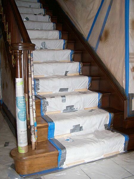

  3. mbdyer | Aug 26, 2005 03:18am | #7
    What is the "white wash"?  Is it pickled, white stained and then clear coated?  Or is it a thinned white alkyd?  If an alkyd, try an oil base dye after a thorough cleaning.  If the dye won't color the pigment or its a pickled, stained and clear-coated oak try a weaker stripper than methylene chloride such as the citric acid based types.  After removing the lion's share of the finish try a bit of the desired dye or a stain, if it takes you're good to go.
    To protect the carpet cover with plastic sheeting taped down tight.  Prior to working lay out loose sheeting or drop clothes.  At the end of each day remove all of the loose drops and wipe the taped down sheeting--wiping away from the tape!  Tape down lauan strips or the like on the treads for safety.

        goldhiller | Aug 28, 2005 08:36am | #13
        shades, <!----><!----><!---->
        Since 3-Fingers hasn't gotten back to you yet….I'll jump in for now. <!----><!---->
        The first thing you need to know/determine if re-coloring/over-coating can take place without stripping is…..what is on there for clear coat finish presently? <!----><!---->
        If you know who did the finishing, they may remember or have records……or maybe you already know. <!----><!---->
        Stripping will be necessary/highly advisable if the current clear-coats are a conversion finish like a cat-lacquer.  Reason being that nothing,  including the same conversion finish, will reliably bond to an existing conversion finish………. including the same conversion finish.  Sorry to say…….it's just the nature of the beast. <!----><!---->
        I wouldn't personally feel comfortable offering further advice/guidance until we know what the current finish is. <!----><!---->
        If you'd like pics of the general procedure (all the masking required) to do re-coloring of a staircase without stripping, I can post those. It's very time consuming as a rule, but can be done.
