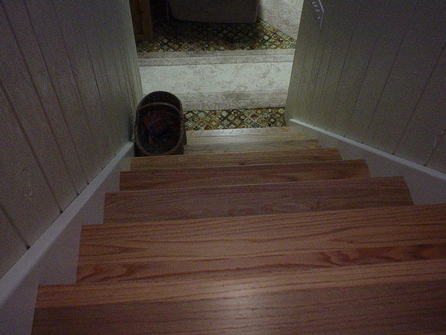

So what kind of stairway does a stairbuilder have in his house?  What do you expect?  Just like a plumber who has a leaky faucet..an electrician who never gets his outlet covers on..I am no different. I did finally rip out my old stairway to the basement and gave my wife an oak stairway after all these years.   !.25 inch stringers that are mortised for the treads and risers.  The run is 10.125 inches…not bad….the rise?   9.625 inches….no..I didnt say 7.625..or 8.625 inches…but a full 9.625 inch rise!!  I had no other option with my space constraints.  She is happy and thinks nothing of an extra two inch step.  I am long legged and usually take two normal steps at a time..so one of these seems small.   What else did you expect.  Ha.    I beg for your mercy as you all shake your head in disgust…

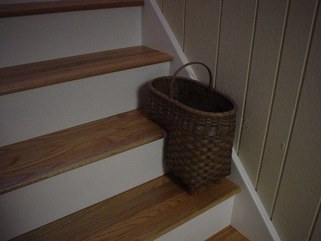

    I loved the basket too!
    Never seen one like that.

      I think the rise had nothing to do with space constraints, but was set to match the basket....chicken and egg...

        There are two small "legs" in the front of that basket holding it up...
        I'll betcha dollars to peso's those were added.. ;)

          I know, but I wasn't gonna let something like that ruin my fun!
        2. StanFoster | Oct 14, 2003 04:29am | #8
          Cag:   You are dead on observant about my cheater legs on that stair basket.  I laughed out loud when I read that.  I mean...where would you find a basket that would fit a 9 5/8 inch rise?

    Nice clean work. But I have  stupid question...is stair code the same everywhere? From my understanding the rise is too much.  At least around here....
    Or, of course, it's your house and hey...you can do whatever!

      Jake:      Of course the rise is way to much..even if it was an inch shorter...but..its always been this way in my house...so it is grandfathered in.  If it were new construction...and I was in an area where they have the codes enforced...it would have to be no greater than 7.75 inches of rise.  In my area...I could have a ladder up to the second floor..and nobody would say a thing.
      My whole point of this post was that I am no different than a plumber with a leaking faucet.  I built a stairway in my own home that I would never have considered doing for someone else.  :)

        Have you heard of the "golden rule" for stairs?  As I remember it, the sum of the rise and run should fall in a particular range – but I don't remember what the actual range is!
        Ian
          GoldenWreckedAngle | Oct 15, 2003 05:11pm | #15
          Oh, oh, oh - I know this one... can I answer? Can I answer... pleeeeeease?
          Thanks...
          The sum should fall between 15" and 19" but if you're looking for "perfect" you hit the magic "Golden Ratio" of .61804 to 1 with an 11" tread and a 6 13/16" riser.Kevin Halliburton

            So Stan's 9.625 rise with a 10.125 run adds to 19.75.    Huummm  he just needs to shorten the run to 9.375 in and they'd be "perfect" stairs !
            Miss,  did I pass ?
            Interestingly, in my 110 y.o house, the stairs have a 10" run with an 8.75" rise
            GoldenWreckedAngle | Oct 16, 2003 05:07pm | #22
            Uh, yea - that'll work... for a slinky.
            Perhaps I should have noted that the minimum tread width in that rule of thumb is 10". Kevin Halliburton

      GEO:   It was kind of a tongue-in-cheek beg for mercy n my stairway.  The absolute truth is that I was so used to the original rise and run..and I did not have to make it to code...so I just built it they way I wanted to.  I could have put another tread in..but chose to keep my run so it would have a wider tread.  I just thought the numbers would be interesting to post.
