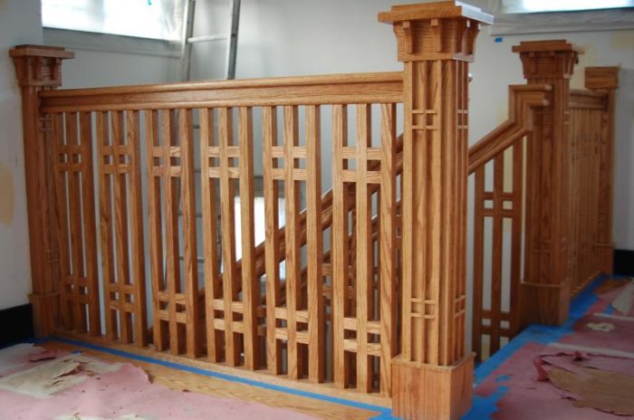

In due deference to the “Stair King” Stan, and fellow Ford County native, enclosed is a little number we’re building on site, with a mantel bonus. Not quite up to Stan’s work, but we’re trying.

1. Your baluster sets with the transverse shorties. Please describe the joinery, shorties to uprights, and subassembly to floor and rail.
2. Are we seeing red or white oak? I can't tell for sure.

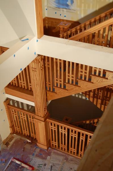

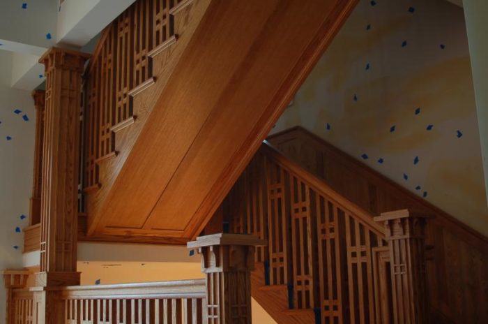

3. Are the stairs built with housed stringers, or are they carriages with applied treads, risers, and skirts?
4. I cannot tell for sure. Are those flat newel caps simple cut boards, or are they done with joinery from multiple pieces so as not to expose any end grain?

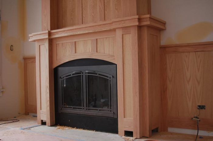

5. On the fireplace front, are we seeing any pocket screw joinery, or is it mortise and tenon, or coped sticks, or what?
The newels are mitered 1x6, with mitered 1 x's top and bottom. Applica's glued and pinned. Caps all mitered. Red oak. The stair is 3 stories, both housed and open stringers with wainscot on the walls. Railings 5/4 top and bottom with a 2x2 stem. Railing screwed to the balusters and then top 5/4 applied. Balasters doweled to tread.Waniscot and mantels, there are a couple, 1x frames, rabbited with ply insert panels, all pocket joined.Thanks.Never serious, but always right.
Oh forgot the "shorties". I started out thinking I would pin nail and glue using a jig for separation. Best laid plans. Because of the staining complexity, we stained 1st then assembled. The glue wouldn't hold to the lacquered stained balusters. Soooo.Using a set of individual spacing jigs I set a shorty on end, double pin nailed it, then drill end ways through the shorty into the baluster and screwed it with a sq drive trim screw, then added the 2nd baluster, drilled and screwed it, then the 2nd set of shorties, pinned and screwed them, and finally added the final baluster pinned and screwed it.Because of the pre-staing mistake, this process was far more time consuming than expected. But the assembly is rock solid.Another draw back, I did so much screwing I got tendonitis.And for all my fellow sick aholes (and we know who you are) that lurk here. I've already suffered all the clever "screw" jokes, so forget it.Never serious, but always right.
