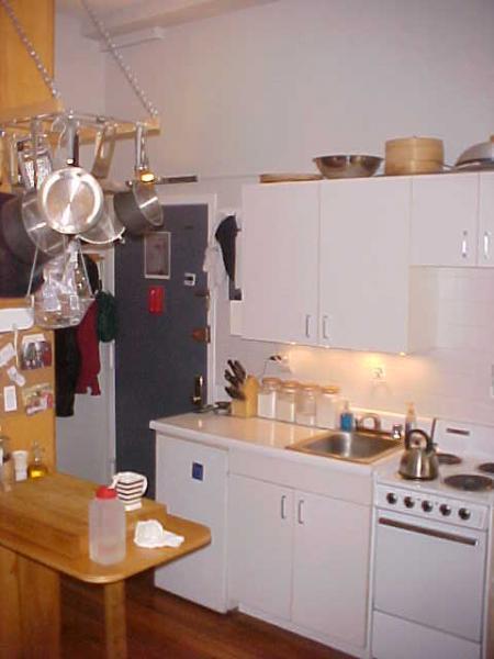

I’m in the process of plotting and planning my near future kitchen renovation. Would love to get some ideas from the BT community.
The apartment is about 300 sq.ft., the ceilings are 10-1/2 ft., hardwood floors. I plan to have the cabinets fabricated via Metropolitan Lumber.
I ordered this sink today, along with this faucet, and this soap dispenser, to be installed in a soapstone countertop.
I’m going to keep the stove (20″) for the time being, but will purchase a new refrigerator (19″ wide by 34-1/2″ high).
My budget is about $15K, and I’ll be doing most, if not all, the work myself. I have access to tools/workspace at my house on LI (it’s rented, but the garage is mine).
I want to put a second tier of cabinets, up to the ceiling, but I don’t want to overwhelm the small room.
here are the dimensions, and the doors are set in stone (literally) and can’t be moved. Otherwise, everything else is negotiable. I included a large KB file of the dimensions scan in case any kind soul wants to print it out and try a few sketches.
Much thanks for any and all suggestions/comments.

Can you try to move the sink left a bit to have some landing space between the range and the sink? Or move the range over to where the wood peninsula top is and increase the work space at the sink area?
I stayed in a friends small apt in Beacon Hill in Boston several times and was kind of shocked at the narrow rooms and high ceilings...I think I would be looking for a way to find or design wall storage that can be pulled down for access and folded back up in on articulated arms for the way high upper cabinets.
I could move the sink about 10" to the left, which would give 12" b/w the sink and the stove.The peninsula leg comes off and the surface folds down out of the way; I like that feature and would like to maintain that flexibility (I've had guest over, sleeping on inflatable mattresses on the floor ... cramped but better than NYC hotel prices ... and removing the peninsula was key to making that happen). Also, there's no electricity by the peninsula, and that would be a big job to get it there (more than my budget allows.)I'm not opening any walls, or changing electrical configurations, so I don't need to get it inspected, nor do I fall afoul of my co-ops rules.The upper tier of cabinets, I'm looking to store stuff like winter clothes, bulk purchases (paper towels and toilet paper), maybe archived tax papers and the sort, the kind of thing where it wouldn't be a big hassle to have to pull out a step ladder when I want access.But I'm thinking maybe to make the cabinet over the counter a short one, like the existing one over the stove, and put an open shelf where I could store the flour/rice/sugar jars and open up a bit more counter space.Marine Engineerfair winds and following seas

here's a sketch of a potential layout.
Open shelving on the bottom of the top tier of cabinets.
Open shelving above the counter top.

I've pretty much settled on this design:
with this detail of one of the upper cabinets:
making similar detail sketch for the lower and base cabinets, is this enough to give to the cabinet maker?
the top tier of cabinets are 36"x36" with an 8" open shelf at the bottom, 14" deep. The lower tier is 36"x30" with a 12" opening, 2 shelves at 6" each, with a centered vertical divider, while the cabinet over the stove will be 24"x18". These two cabinets will be 12" deep.
The base cabinet will be 36"x34.5"x24" deep. The base, lower and upper tiers will stack visually.
