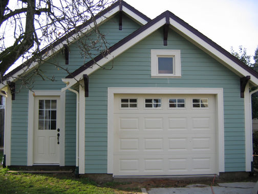

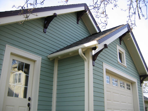

This is an enormous thank you to all the people that responded to my questions (as simple and basic as some of them were) during the construction of my Portland, Oregon detached garage. As a slightly-more-experienced-than-a-novice DIYer, your help was extremely appreciated. But, I’m sorry, I’m not posting a billing address for your invoices! 😉
Attached are some photos of our (yours and my) work.

Beautiful job. You have very good design taste.

Now that's a fine looking garage! Good on ya.
Sweet, pleasing to the eye, you done good. Congratulations.
We likes it!

Very nice crisp detail.

That's good stuff Jason, looks great both in terms of fit & finish as well as aesthetics. Two quick questions for you if you don't mind:
1) what is the siding material?
2) what sort of paint did you use and how did you paint it?

I like the clean lines and the style. Nice work.

1) The siding material was smooth fiber cement (Hardie). 6-1/4 in. Lapped for a 4-1/2 inch reveal (typical of 20's homes in the area).
2) I used the premium exterior latex paint manufactured by a local company, Miller Paints. They specialize in formulations that work well in the P. Northwest climate.

Great proportions in all respects. Beautiful. And not the least bit pretentious either. I like the idea of reflecting local traditions with respect to siding overlap. Sweet.
Now we want to see a pic of your house. ;)
Looks like a seamless addition, great job!

That is one good looking garage.

looks really great jason, i like that look a lot...
what did you end up using for trim? what size?
you got any pics of the left side, right side, backside and inside?

I'll try to decrease the file size of a few more photos at home tonight. A few details on the construction:
The siding is Hardieplank, smooth. The trim is FJ Cedar, smooth side out. It was pre-primed, but I sanded a bit and re-primed all the exposed surfaces. Backsides were left with the factory prime. Rakes are 2x, cornerboards are 5/4, window and doors are 1x with outside corner molding - primed all sides. The rake board tail details were taken from one of my favorite houses in the area. The small window above the garage door was taken/saved from the original garage - sort of 'old meets new' (the former garage foundation visible in one of the photos). The underside of eaves are beadboard for another detail. Most everything was purchased from a local lumberyard, with the exception of special order items like the door and garage door purchased at HD or things I needed to pick up 'after normal business hours'.
