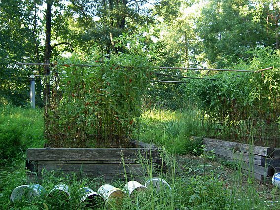

    When determining dirt depth, consider what you're going to grow and how it's going to be watered.  Here's ours:
