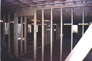

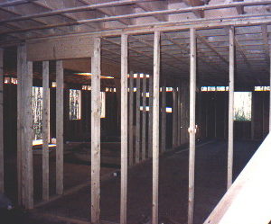

          13. User avater
            Qtrmeg | Jun 23, 2003 05:23pm | #21
            "Is strapping putting up furring strips (like 1x's) perpendicullar to the framing"
            Yep, this picture is with ceiling strapped, ready for interior partitions.

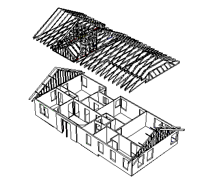

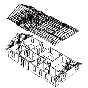

          14. Boxduh | Jun 24, 2003 02:33am | #22
            Attached is a graphic of the upper floor of my current project, now finishing up foundation stage.  The reason I am showing this is to ask a question raised by one of the recent posts to this thread.  You know, the one with the photo.  I believe the description accompanying the photo was something like, "strapping up and ready for partitions."
            What comes first, strapping or interior wall work?
            It would certainly be easier to strap this whole booger with the trusses on and no interior wall work done yet, but my framer's intent is to build all the walls, then place trusses.
            So what is up with you guys that strap always, when you have a trussed job like this?
            I was sort of looking at the strapping as the means of bracing and fixing wall tops, for the interior walls.  Sort of a way to eliminate those Simpson STC truss clips, that let the truss chord raise up off the plate while still fixing the plate's lateral position.  For walls parallel to the strapping, straps up tight to the top plates, both sides, do the same job as the STC clip.  For walls perpendicular to the strapping direction, we might just but the strap ends up tight to the plate edges.  Again, same effect as the STCs.
            On another note, I will want to remind my wall and ceiling finish guys not to screw rock sheets to straps at wall perimeters, and hold back all screws for ceiling panels a good 12", because of truss chord movement potential, straps or no straps.
            So, what do you strappers do?  Strap first, interior walls second?  And secondly, how do you handle fixing of wall tops when strapping, and the walls are parallel to trusses, and therefore perpendicular to straps?
          15. Piffin | Jun 24, 2003 02:56am | #24
            You can do it in either order. For one like that, it would be easier strapping first but I can see that it will be much easier to raise and ty the walls together with no trusses up.
            I don't use trusses so can't comment on the other items.
            Since most of mine is remodeling, the walls are generally already there. When a house has settled and has sags, the strapping heals that up. I shim level to the lowest point. That means that there are times when each room has a different finished ceiling level..
