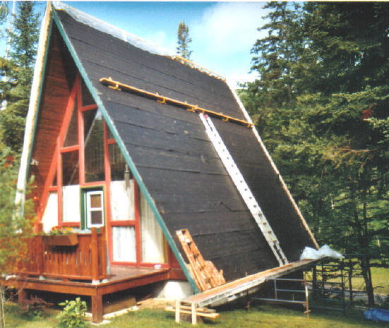

The main issue in this job was access: the roof itself was 25 in 12, a true A-frame chalet built about 30 years ago that was recently bought by a doctor looking for a weekend place up here in ski country. The doc is the first owner in many years to have any dough to put into the place; previous to him the house has been owned by a succession of ski pros, patrollers, and other low-income types. First thing he did was jack it up and put a basement under it; then he had us come in last fall and rip out and replace the entire rear wall. It was, of course, non structural, so it presented no issues other than aesthetics. We were supposed to do the roof after that–but winter caught up with us and nobody in his right mind does a tear off and re-roof up here in the winter. By the time we finished the rear wall in late October, we were shoveling a couple of inches of snow off the scaffolding and scattering ashes on the platforms each morning….
The original plan for the roof, as conceived by the HO, was to build a 2×6 crib (on edge) on top of it, foam it, and cover that with some industrial steel siding he’d picked up cheap. We checked out the cost of foaming; it turned out to be unreasonably high so we found a manufacturer of rigid polyiso foam board (Atlas Roofing) and special-ordered 180 2×8 sheets 3″ thick. We went through a few different plans on how to place it; finally it was decided to use 2×4’s on edge as a vertical rack, lag-bolted in place between each row of insulation. The stuff came in last fall while we still thought we had a chance; fortunately my yard was willing to store it over the winter for us at no charge–I don’t want to think of what might have happened to it sitting under tarps for 6 months in the HO’s side yard 40 feet from the main road throught the village.
The weather this year was weird; we finally started this job on the day after Canada Day, hoping for our usual hot and dry July to get things done under good conditions. We didn’t get it. We got hot–but not dry. There were something like 8 rain days we couldn’t work during the three and a half weeks we were on this job. And tarping that monster was worse than doing the actual work. My biggest tarp is 30×40, more than big enough to cover half the house. But sitting up on that pointy ridge and manhandling the bloody thing almost caused me to go back to working in an office. Shinnying back and forth yanking that tarp around I got the worst case of sewing machine leg I’ve ever had. I rigged window-shade rope pulls on it so we could haul it up and down from the scaffolding level after the first time, but there was too much crud in the way and it didn’t work. After two days of this misery, I hauled down the tarp and put up poly sheeting: a lot lighter, easily as waterproof if not more so, and at only 10 feet wide per section it was a hell of a lot easier to handle. The first side of the roof was the hot side; as a result 80% of the tarpaper shredded as we stripped. But on the shady side of the roof we were able to preserve almost all of the black paper when stripping the shingles, and so we had less worries. We only had to sheet the portions that had been insulated each night. (See ‘Roof 1’)
We were able to set up stepped scaffolding to give us a level work platform even with the edge of the eaves on each side. For stripping, we just roof-jacked our way up the roof using 60-degree roof jacks and 2×6 planks. We set up ladders off the main scaffolding to get up and down to the roof jack level. Moving the jacks up the roof took two of us a solid half hour each time; that was one of the many manoeuvres that caused the job to take so long. (see Roof 2)

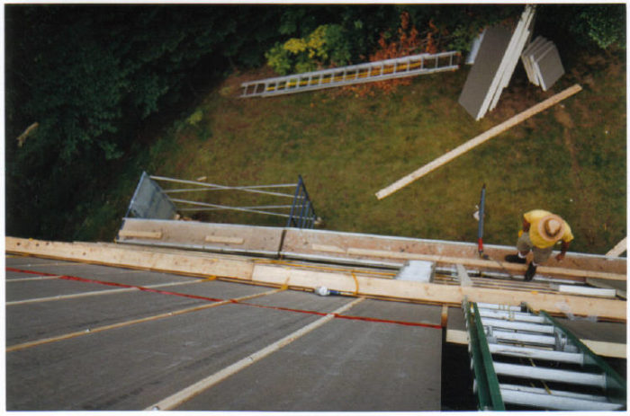

Once the roof was stripped we started laying up the 2×4’s and the insulation. The 2×4’s had all been pre-drilled; one of the crew set up a work station and gang drilled the 14-footers on 24″ centers with a long auger in a half-inch Makita drill. It took him about half a day to drill them all and stuff the 6″ lags and washers into the holes. We used a pneumatic impact gun to drive the lags into the roof deck, which was made of 2×6 T&G roof decking. I had to be very careful not to overdrive any lags; the inside finish of the house was the underside of the roof decking; no interior insulation or ceiling whatsoever existed, and the HO liked the look of the v-joint ceiling and structural beams of the A frame. (I actually burned out one impact gun during this phase–damn near 600 6″ lags into dry red pine–which gave rise to the post about Campbell Hausfeld’s parts policy last month; I finally got the part, BTW.) See photo Roof 3.)
As we got further up the roof, we attached roof jacks to the 2×4’s and were able to set a 20′ ladder on the jack plank to give us rake-to-rake access without moving the big 30 footer every couple of minutes. To prevent any mishaps with ladder feet kicking out from the 2×6 jack planks, we reversed the feet and jammed them into the space between the jack plank and the roof. See photos roof 4 and roof 5.
Just so you get an idea of what it was like up there, see Roof 6.
BTW, I forgot to mention that even using 60-degree jacks, the roof was so steep that the planks were still sloping away from the roof just enough to be really tiresome. To remedy that, we shimmed out the foot of the jacks by setting them on the furring. If no furring was available, we just inset a piece of 1×3. This brought the jack planks dead level, and was so much more comfortable to work on it was hard to believe the difference. See photo Roof 7.
Once we had the 2×4’s bolted to the roof all the way up on one side, I installed a ridge board to them to give me a place to land when we did the other half of the roof. We had found that the insulation board, special order that it was, was not cut exactly uniform width–the supposedly 24″ wide boards varied from 23-5/8″ to 24″, so we knew the rows on each side of the house wouldn’t necessarily line up. This ridge board also gave us a solid support for the metal cap that had had to be specially fabricated to cover the ridge and seal using foam inserts. See photo roof 8.

1) Get some 90 degree roof jacks. They're a little less periless to set ladders on like you were doing and they feel a whole lot better when you're standing on them on a steep pitch.
2) You might want to consider using a boom lift on the next job you get like this. I've done similar jobs by myself with one of these machines. Climbing up and down and moving setups becomes a non-issue. I can't really tell from the pictures if you had the room or terrain to get a machine in there.
I've got a few 90-degree/2x10 jacks that we use for 'normal' roofs, but nowhere near enough to cover this job. Unfortunately none of the yards in town had any matching jacks in stock when I ordered my materials; in fact I had to start with not enough 60-degree jacks and finally got another 6 the second week we were up there so we could set up two full rows of jacks at one time. That helped a lot when moving up or down .
The ladders were actually very solidly planted stuffed into the crack there; neither kick-out nor side-swing was ever an issue, and my HD 20 footer was doubled up most of the time giving me a nice generous two rung foot platform; very comfy through my special 'roofing shoes' (nice, soft, old, light-weight sneakers).
Unfortunately as you guessed, I didn't have appropriate terrain for a boom lift; the slope on both sides of the house exceeded 3 in 12, way too steep to drive the machine on. There was no other access on the lot (it's small) for the boom without bringing in a shovel and creating one, which would have destroyed the HOs landscaping--not an option. A 60-foot boom could have reached from the front of the house, but there were trees and power lines in the way on the SE side of the roof that didn't show in the pics, and I tend to think the effort would have been more of a dog's breakfast than anything else. Also, the cost of renting the 60-footer for a week would have been equivalent to three days billing for the entire crew--two carps and one apprentice--and I don't think the boom would have saved us three days per week.

Wow! That was some roof structure to be working on. #8 picture gave a really interesting look at that pitch.
