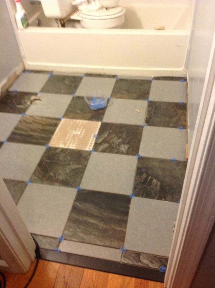

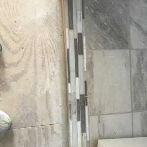

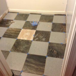

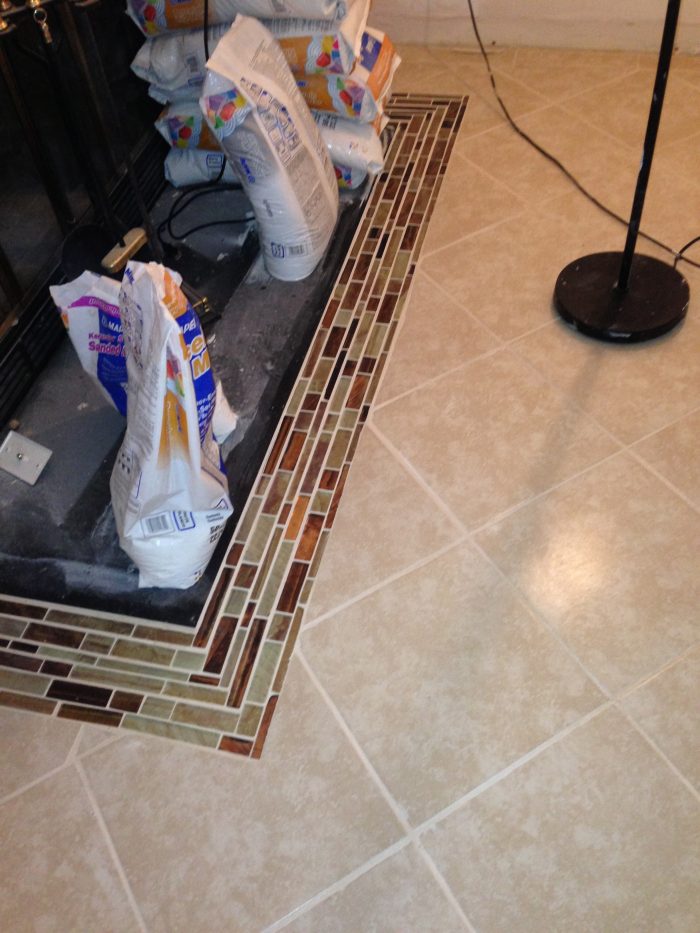

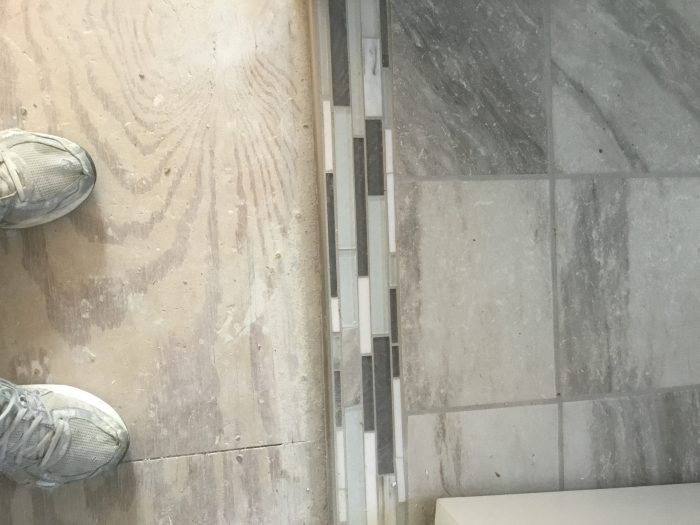

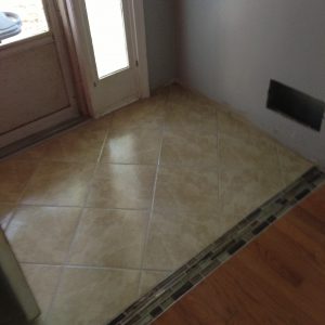

  8. attackgirl | Apr 01, 2019 08:03pm | #8
    As everyone also recommends moving the tile and adjusting you can also try different patterns; straight-line, diagonal, Brick, chessboard, herringbone, basketweave on and on. I always lay out the tile every piece and make adjustments as necessary for visual appearances taking into account Feng Shui but also feeling under the feet, you don't want to sit on the toilet and have your feet on the crack or 4 way meeting when a slight adjustment will suffice or also sitting on the toilet looking down or across the room dead ahead at the tile and seeing those slivers, or for the gentlemen looking behind the toilet to see messed up tile, or stepping out of the shower onto a drain.
    Sometimes doorways are your saving place as suggested making thresholds will allow for pattern changes, grout color changes etc to help build a rooms character all using the same tile. Walk into a long kitchen with a staggered pattern making the kitchen seemingly bigger and drawing your attention in then a threshold area to stop your gaze. Then imagine coming in from back of the house into the laundry room the herringbone will lead you in but keep your gaze in the room, so play with the tile. To busy of a tile and you do not want a complicated pattern it's exhausting.
