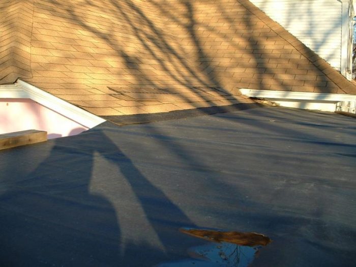

Got far enough along with the flat roof that one piece of the EPDM is (mostly) glued down.  Rain/cold/darkness stopped us from attaching the upper piece, in the pic below.  I’m wondering where the best place to change from shingles to EPDM would be?  I have about 2 extra feet of material to play with, so could move the EPDM up to 2 feet further up the shingled roof, or stop it where the two different slopes meet, or ???? (Also will need to move it so it extends up that gable wall.)
Should the EPDM go far enough under the shingles that nails will penetrate it?  If so, about how far?

    photo attachment too big for me but the flat roof material always needs to go at least 18" up under the shingles.

      RichBeckman | Dec 08, 2004 05:55am | #5
      "the EDPM degrades when in contact with asphalt"When I enquired about this here a few years ago, it was explained to me that the asphalt being referred to is fresh roofing cement and similar products (maybe even some of the ice/water shield stuff?).The asphalt in the shingles is not a problem.Rich BeckmanAnother day, another tool.

        1. jarcolio | Dec 08, 2004 04:42pm | #7
          I have heard the same thing about shigles eating EPDM; on two EPDM roofs I have done that marry with a shigle roof, I always place the EPDM and then a roll of alu coil stock between the EPDM and the shingles -- shigles rest on the coil stock -- roofs have held up for 20+ yrs-- all the best -- dudley
    RichBeckman | Dec 08, 2004 05:30am | #3
    I would go as far up as you can with the rubber and then, as Piffen suggests, bring the shingles back down to cover the top 18" or so.
    The valley complicates things quite a bit. I'm not sure how I would deal with that.
    It is my experience (which is a bit limited) that it is best if the shingle/epdm transition is taking place as far above the slope change as possible.

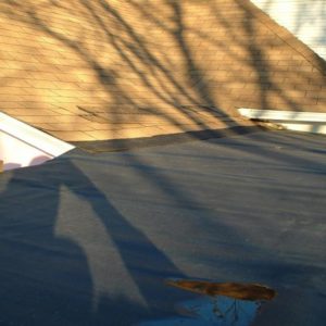

    Here is the pic resized.

      RichBeckman | Dec 08, 2004 05:35am | #4
      Sorry, I missed the attachment.Here it is:
  4. rez | Dec 08, 2004 07:39pm | #8
    Greetings Tab,
    I got to wondering how you are going to address that valley trim intersection here.
