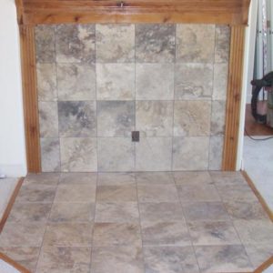

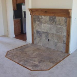

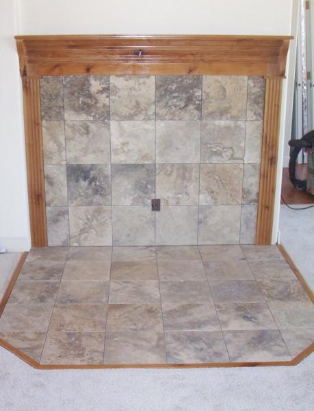

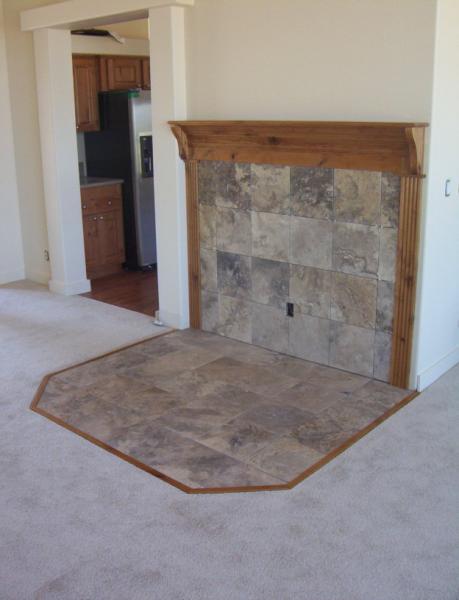

    I just did a tile to carpet transition on a wood stove hearth and used wood.  Milled rough stock to the same height as tile with a 1/4" bullnose edge on the carpet side.  When using wood against tile it is a good idea to use a latex caulk grout to allow for the expansion and contraction of the wood vs tile.  My latest Mcmansion project, triple wide manufactured home with a hearth and custom mantle  with 12x12 travertine tile!  Pics follow
