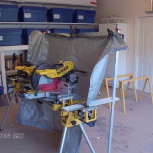

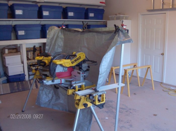

    I have a couple of cheap 5' aluminum bar clamps set up behind my stand. I clamp a 6' level in the jaws for a top brace and hang a 6x8 tarp.
    In low light areas I put a few 100w clamp on lights across the top bar. So much easier to be accurate when you can see.
    The contraption is easy to set up and knock down, takes up hardly any room in the truck and catches an amazing amount of sawdust.
