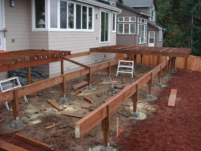

Here’s a multilevel Trex deck we just started
Posts and 20′ 4×10 beams ……..Man this new ACQ is heavy…………….
We had a hard time shoulder loading these heavy pigs…….

    Framing 1' on center

      three foot canterlever"Rather be a hammer than a nail"

      1. DaveRicheson | Nov 09, 2004 02:16pm | #7
        Tell me about your piers and post connectors.
        As ussual, outstanding work, Bob.
        Dave
        1. xMikeSmith | Nov 09, 2004 03:11pm | #10
          yeah.. me too, bob... what's your frost line ?  how deep are your footings...
           you've got a lot of footings.. could you have increase the beam size and reduced the number of footings ?
          sure make me jealous to go get another deck..
           oh well, we do have two small ones comming up on our current job..Mike Smith   Rhode Island : Design / Build / Repair / Restore
            ProDek | Nov 09, 2004 07:00pm | #14
            Thanks Mike,
            Our frost line is only 8" here and the ground is like concrete. There is softer soil on some of the hillsides around here which require deep Sono tube footings but most of the decks I choose to do are on hard flat ground.
            The reason for all the footings is the different elevations of the deck. I designed it so when you were sitting in the house you could see over the railing at the incredible view. We can only span 8' with a 4x10 Doug fir beam today. I used to span 10' with no bounce at all.
            I sure like the new FastenMaster ledger fasteners for jobs like this.Instead of a 3/8" lag they are 3/16" and easily drive into wall studs. I'll post a picture later.
            better go put on my knee pads................."Rather be a hammer than a nail"
            Bob
          ProDek | Nov 09, 2004 06:31pm | #12
          The post and pier connectors are adjustable 4" saddles. The allow you to turn the nut at the base of the saddle to level your beam run if you cut the post on the wrong side of the line.........................:-)
          The 2x4 gussets on each side of the post keep the beam from twisting off of the post when the wood dries."Rather be a hammer than a nail"

      ProDek | Nov 09, 2004 06:44pm | #13
      Thanks Mojo,
      The footings are 18"x18" x 8" deep with two pieces of rebar in each hole. Our frost line is 8" here and the ground is more rock than dirt.
      Our PT is Doug fir and we request brown treatment instead of green because it looks better from the underside if it goes unpainted.
      The deck screws are C-Deck fasteners. They are 2 1/2" long star drives with a self tapping cutter wood screw thread at the point and a fine machine screw thread at the top that pulls the fray of the Trex back into the hole, making for a nice clean set.
      The screws are also colored to match the color of the Trex.
      Bob
