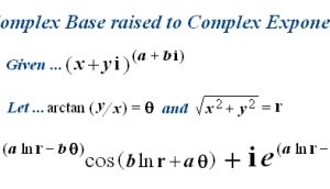

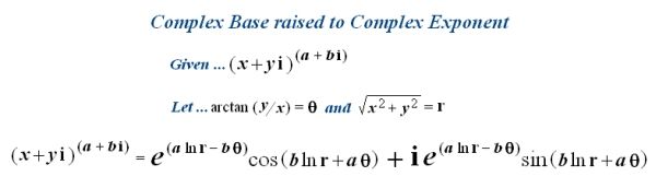

          4. JoeBartok | Feb 14, 2009 10:17pm | #14
            Junkhound, as usual on a Saturday I am running out of Internet time (just when someone post a really interesting question ... also as usual). Nor do I have time to scan my math notes to show the derivation of the formula in the image below.
            If you elect to use the exponential function based formulas for your worksheet you will find the relationship useful. This is the formulation I used in my web-based calculator to raise a complex base to a complex exponent.
            Since your base is e + 0i, r = 1 and theta = zero, dramatically simplifying the formula.
            Real Compnent = e ^ a × cos b
            Imaginary Component = i(e ^ a × sin b)
            You can use my online calculator to check the powers of (e + 0i)^(a + bi) against the values returned by your spreadsheet.
            Hope this helps you out ...
