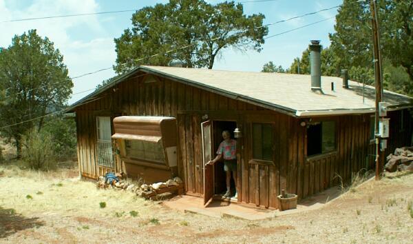

          10. User avater
            intrepidcat | Jun 26, 2008 03:35am | #12
            Well, that's pretty neat in the picture.
            You gonna tear that down?
            Hope you keep us posted on this trailer demo. I bought a place recently also and it has an old trailer that is in such bad condition I don't think it would get 10 miles ( maybe less) down the road before falling apart. Thought about just getting a dumpster and just cutting it into pieces and throwing it in then using the frame for a trailer or something.

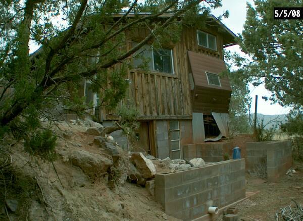

          11. joeh | Jun 26, 2008 07:29am | #13
            If you could see the inside you'd be for demo too.
            That trailer is 42' long travel trailer from approx 1950.  Inside of the house is dark and small, painted dark maroon, brown wood, low ceilings.
            Lot of wasted lumber is about the best I can say for it. Built like a brick sh!t house, but nothing I want to keep. It would make a nice shed, but it's gotta move from where it is so demo time.
            I'll be posting the project, but guessing next year before I can get started on it. Too far to commute, about 800 miles each way. Have to sell here first.
            Joe H
