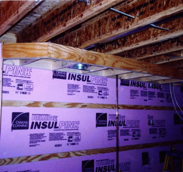

I prefere to use foam insulation on the outside. Piffin has explained it depends on the climate. Down south they normally put foam on the outside. I live in Chicago. I also know from previous threads the wall has to breathe. Foam on the outside with a vapor barrier on the inside will result in disaster.
Now am I nuts……… If I plan to use a 10′ 4.5″ wall with a drop ceiling , lowering the ceiling to 9′. If I use 10′ wall board with a 1/2 inch space between the floor and wall board, then I will have a gap of 1″ on the top, and have exposed fiberglass insulation (unfaced) . Would the wall then breathe????? I have a hunch it would be a fire code issue
What do ya think???

I'm not sure about those gaps at top and bottom, but tal;k you your local Dow Corning rep; they have a whole presentation devoted to the advantages of foam on the outside and the condensation question.
