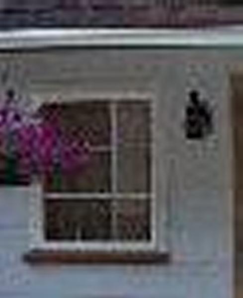

Well here's a pic that kind of lost it's luster in the crop and resize. This is on my henhouse but I do it on real houses too. rip a 2X @ 12 degrees on the back...assemble it on a stool of a size to suit you (12 degree outslope on top of the stool for the sill to lay on).
Build it long enough so side trim (beveled 12 degrees on bottom) sits on top of it.
This is just one method but it looks "unvinylly" (I made that up) when you're through.
Well, here's the henhouse:
