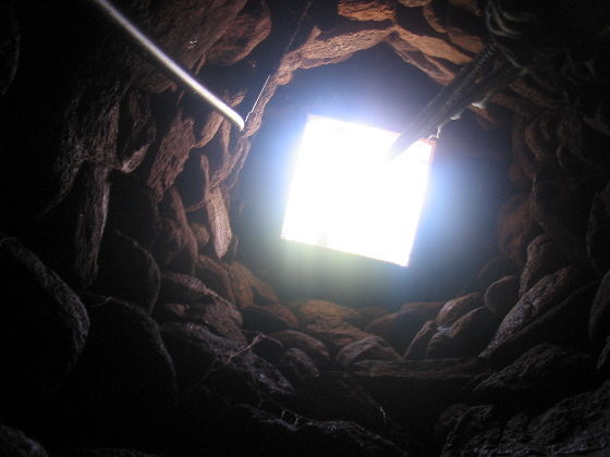

Raised in the city, and now living in the country. It was no problem going down my well to straighten out the water line which has been sucking air on occasion this summer. I rigged up a rope chair on a pulley and test drove it in the basement, it was similar to one I used in my 20’s to repair grain elevators. I soon realized the 50 or 60 lbs I’ve gained since then may not all be muscle, so I quickly added more pulleys. I placed a steel beam over the well, chained up my pulley block, and with the DW as a witness, lowered myself 16 feet into my dug well. I straightened out the curved plastic line with a 10′ stainless steel angle and fastened with cable ties. I got the line 2′ deeper into the water. I had alot of fun doing it and thought the result was well worth the effort.
Later friends were telling me horor stories of people going into wells and being overcome with gas, CO2, etc and dying. Was I just lucky?
going into a dug, large diameter (36") WELL is not that dangerous as far as any "deadly" gases, etc, that may overcome you.
Now, going into a SEPTIC systems holding tank is a whole different ball game.(deadly)
The only thing stupid was not having someone strong enough at the top to pull you out if something happened that you were unprepared for.

200lbs and 20' is a tough pull unless married to Schwartzneger (not) or have a winch handy. DW had a 28' ladder roped together to drop down in case. Never thought about passing out.

I roped myself down so I wouldn't disturb the water, ladder would have mucked the well up for days.

Just think about the guy who dug the well ! 16' isnt anything around here for a handdug well. Ive seen them 40-50'. Theres one well just over the mt from me that is about 35' lined with the stone and the opening was only about 20-24"! How did they lay the stone? Hanging from thier heels on rropes?Ive heard of digging old septic tanks by undermining concrete rings as u go down but not stone.There wasnt even room to move ur shoulders. " Hey Jethro could u find me another rock I dont like the face on this one.. something about 9" with the left side flat and the right side sloped?

I think I would have lowered a lighted candle or some such first. Or at the very minimum, have it setup so that someone from above could pull ya out.
And keep an eye out for snakes or other wonderful things.

Please be careful guys. Most fire depts. and rescue squads will let you borrow a monitor to lower into the hole first. There are way too many news reports of people getting overcome and then the next 4 or 5 would-be rescuers also dieing in the attempts to save them without some type of SCBA gear.
I work in a plant and confined space safety is taken very seriously but it seems most of the deaths occur in seemingly harmless places; farm manure pits, septic tanks, electric manholes, etc. Please, take some precautions, if not for yourselves, then for the rescuers who could be killed. JMHO and 2cents. I'll get off the soapbox and shutup now. <g>.

I would not say that you were stupid, just uninformed. A hole 3 feet wide and 16 feet deep is an area where heavier than air gases settle and displace Oxygen. I was a fireman for 20 years and would read the fire magazines, the magazines would have stories all the time about situations like yours where someone would go down the hole and pass out, then someone else would try to go down to save them and also pass out. Some cases would require 3 or 4 people passing out(sometimes firefighters) before someone would realize that there was something wrong with the air. Many of the folks who passed out died. So just because you did this a few times in the past, don't assume that it can't happen if you try it the future. There is no reason to beleive that a dug well hole can't contain a lack of oxygen or toxic gasses. OSHA considers the well to be a confined space that needs atmosperic monitoring before entry. People advising that it is OK to go down a well like yours, the way you did, are encouraging others that what you did is safe, and that could get someone else hurt.

To answer your question, no. The odds that the air would be good were pretty high, and you would have had to have been very unlucky to have killed yourself because of the atmosphere being toxic or oxygen deficient. But the possibility was there. Be safe.
Amateurs talk strategy, Generals talk logistics.
The concern would be that slow bacterial action could have depleted the air of oxygen and left it high in CO2. If it only used up a third of the O2 and therefore had about 4 to 5 % CO2, you would have had tingling in your lips and an overwhelming sensation to breath hard and deep. I know people who experienced that in caves. But if more O2 than that had been used up, you'd pass out before you noticed the signs.
Lowering a candle ALL THE WAY down is a good idea. Above about 3 % CO2, the flame can't sustain. You could however breathe that 3% CO2 / 16% O2 air with the above-mentioned symptoms (That's what mouth-to-mouth reciptients get).
I've dropped into caves on a single rope (rappel down, have "Jumar" ascendors to come out) in which either a Bic lighter or an electronic snifter is used to check the air as you go. The separation between atmospheric and stagnant air can be VERY abrupt. I've flicked a bic and lowered it with the flame on. As I lowered the lighter thru the transition the flame stayed above that level. The butane jet went several inches through the oxygen-deficient air until it was in the air above and could burn. Very odd to see a flame floating 2 inches above the lighter.
Once way to eliminate most all worries would be with ventilation. Extend an electric shop vac hose (with 2" pipe) to just above the water. Let it suck for 10 minutes. Then go spelunking. Use no combustion equipment. Carbon monoxide and enclosed spaces are a bad combo.
reading the posts i was wondering if at only 16' if just a good sized blower blow'n down into the well would make it safe or safer? the post about the electric leaf blower... might just work...? I'm sure most on this board have done many things that could have left em with nothing but their name carved in stone somewhere... seems i do it most days... someone has to do it...
p
I think a leaf blower would do for only 16 feet. Seems like you would feel a breeze on your cheek 16 feet away, so it would stir things up a bit at the bottom. And provide a lot of circulation up higher.
I was trying to be conservative in my recommendation of sucking air from the bottom of the shaft. Because the air that is partially oxygen-deficienct and CO2-enriched will be denser than atmospheric air and so will have pooled in the bottom of the shaft.David Thomas Overlooking Cook Inlet in Kenai, Alaska

Never enter a confined space with makeshift rig, no monitor for O2 saturation, hazardous vapors etc... Electricians who enter manhole have specific requirement for spaces as shallow as 3 ft! Heavier than air vapor accumilate and sit in a space and you drop in it....
They have to run a fan and blow or exhaust for a specific amountr of time and then lower a monitor to verify safe atmosphere before attemting to enter and that is strict even for their special waivers..
You risked your life and got lucky,
Entrapment is another issue altogether, colapse etc....
Don't try that again... any "well" guy will tell you the same

Another firefighter here, putting in his .02.
Bad idea. Confined space, by definition. No idea of air quality. ( yes, probably ok, but when it's my #### on the line, I want better than probably) No professional fire dept. would go down there and perform a confined space rescue without scba unless air monitoring to the bottom and every place in between had already been done.You got lucky, and so did your town's firefighters. Be safe & Don't do this again.Guys that do stuff like this, and THEN ask for advice are job security. :)
Bing
The most common cause of death among workers in confined spaces is suffocation due to lack of oxygen. A lack of oxygen is totally undetectable. The first organ affected is the brain (it has only 5% of body weight but uses 15% of the oxygen), which prevents the victim from being aware they are passing out. In many cases well-meaning rescuers climb down to retrieve a passed out co-worker and die themselves, too. That's one reason why OSHA spells out specific procedures for entry into confined spaces.
Oxygen is remove by rusting, so steel tanks are nearly guaranteed to be oxygen deficient. Your well could also be, due to biological action. Additionally, CO2 is heavier than air, so the danger increases the deeper you go.
In an industrial setting no one would be allowed to go into a space such as your well without conducting a test for oxygen level prior to entry.
