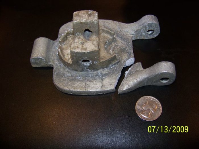

"DW was helping me take it down last week and it got away from her, torqued the base sideways and popped off an ear."

I'll try to posta pic of the busted piece, it's not a thing of beauty to start with. Looks like a low dollar casting."Put your creed in your deed." Emerson
The roundish stub fits into the base of the mast. The two ears on the right mate with a fitting on the deck, a 1/4" bolt acts as a pivot. The ears are to the rear of the mast. You lay the mast down, hanging over the stern, align the holes, insert the bolt, and pivot the mast upright. The forestay, a cable attached at the top of the mast, then clips to a fitting on the bow and keeps it upright.

That would be an easy sand cast.
Lay it on a hunk of plywood just like it is. (Super glue it back to gether first, and tape over the drilled holes.) Dust with talcum powder. Make a plywood box about 6x6 x6 and place it around it. Mix some dry sand w/old motor oil and sift it over that talc coverd part. Pound down the sand lightly and keep going till the box is full.
Cap the box and flip the plywood base over WITH the capped box. Gently remove the plywood base, and gently tap the mast part. remove it, and melt it. Maybe add an old lawnmower piston for extra alum.
Pour it in the cavity, let cool and drill your holes out.
Polish it up and yer done. Maybe even cast it in brass for a nice touch.Spheramid Enterprises Architectural Woodworks

This would also be a trivial thing to get welded since he can carry it into a shop.
Sand casting is exactly what I was going to suggest.Only I wouldn't melt the old casting, and re-pour it.I'd find something else to melt and pour. Bronze being probably the best option.That small a casting wouldn't take much.With the old casting intact, you'll have a pattern for drilling the new holes, and taking off casting overruns and warts...We are smart in so many ways. Surely, we should be able to understand that in between war and passivity, there are a thousand possibilities. ~Howard Zinn..You are always welcome at Quittintime

After seen the pix, If it were mine, for a quick fix, I'd screw a piece of angle iron or Al to the base and drill a hole to match to get thru the summer.
As others have said, hard to see the puddle, plus AL has good thermal conductivity which tend to produce more melt than one wants.
