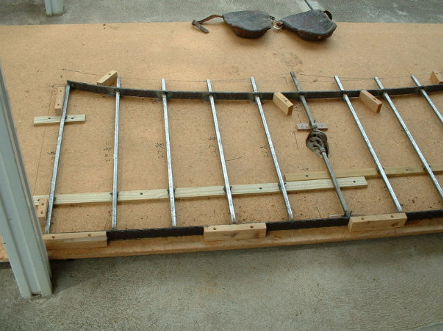

One pic shows the metal laid out on a piece of particle board. I laid it out full scale first and then just fixed the metal on top of it. There are spacers to get everything where it is supposed to be.
All the panels will be this size. Yes they are small.

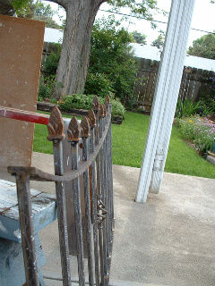

The other pic shows the panel built. I still have to add some metal leaves at the bottom of the center picket.
there are two curves at the top. the one is the rail that has a gentle bend and then a flair on both ends to give it some old style look.
Then the pickets do there own thing with the middle one taking the cake.
Each panel will have 2x2" posts at the ends with a bigger final on it. so where you see the pickets stop at the ends there will be a bigger top.

Here is a better pic. You can see the curves better.
