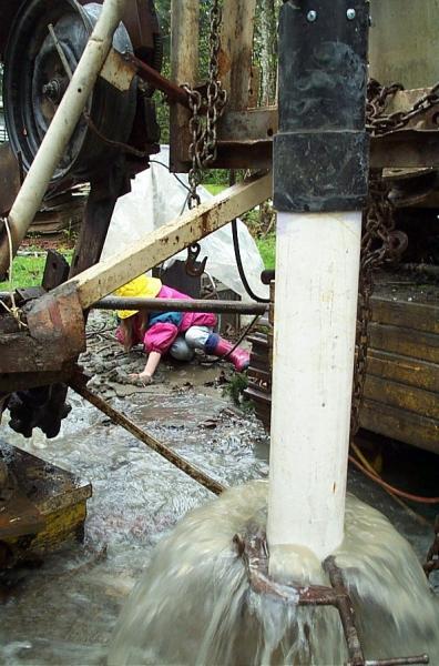

The attached pix is the 500 gpm loaded with fine sand coming out the 8' casing, after the flush, pumped 29 gpm from 60 feet (biggest pump I got) for 10 hours with no slowdown. Before the flush the well screen just clogged with sand.
