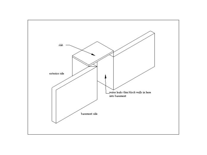

Hello to all. i have attached a drawing of a section of our basement in our 1938 vintage home. the old well has been sealed off in this little room. we get rainwater coming into the basement thru the block walls. we are wondering the best solution to this. the block walls in the little room are pretty dingy, moldy, etc. i havent had much experience with this type of problem so im not sure where to start.
I would guess, maybe wrong, that there is no downspout in that corner of the porch-so we might be able to rule that out as a source.
However, many of those - cold room - type spaces below even covered porches seem to draw a leak. Most often you can look to the joint of concrete slab/wall. Further, if settling has occured there might be an entry point where the porch wall joins the basement foundation wall.

1. Check your downs spouts - are they draining too close to the house?
2. Is there weeping tile at the footings? If not, put'em in! If so, is it functioning properly? Is there any blockages?
3. Trench around the house and install Delta MS Membrane against the foundation. Install weeping tile at the same time.
Dave
I have a cold room under the concrete front steps. When we first moved there, it leaked real bad during any rain. The house needed tuckpointing, and I explained the problem to my mason. He repaired some cracks around the stairs and it's been dry for 5 years now.
1. Direct rainwater well away from the house. Add downspout extensions if necessary. (The plastic, telescoping ones are convenient because they can be moved when needed without detaching). Install gutters and downspouts where they are needed, if dripping is a problem.
2. Sealing/waterproofing the interior wall won't work for long--the hydropressure of water from outside will push off any interior sealant. Waterproofing works on exterior walls only (water will push the sealant ON to the exterior wall) if you're willing/able to dig. A trench would have to be dug to a level below the foundation and drainage stone added so water drains to a level below the bottom of the the foundation wall and floor.
3. If you can't stop water from entering, a perimeter trench can be dug in the basement to collect water as it comes in. The water is then carried to a sump or drain in the floor. Danger here is that the floor can crack if it isn't thick enough to withstand jackhammering, and the process creates a lot of dust. The trench is lined and then covered with a grill.
4. Use a dehumidifier to deal with moisture coming through the walls. Below 50 percent humidity, mold cannot grow.
5. If you have anything in your basement that draws air, such as a clothes dryer or furnace, be sure you provide an in vent to pull that air directly from the outside, not through/from your damp basement walls.

yup, that is the boat we are in. the water doesnt flood the basement, just gets the floor wet near our washer/dryer & we have to squeegie it into the drain. the rest of the basement gets moist on the walls, but dont leak standing water. i can probably route the water that comes in this room to a drain near by it with a caulk "gutter" on the floor...

Sounds like a good, inexpensive approach and worth trying. I forgot to mention that we lessened the amount of water coming in by caulking along the exterior where the foundation and driveway meet with a driveway joint caulk.
