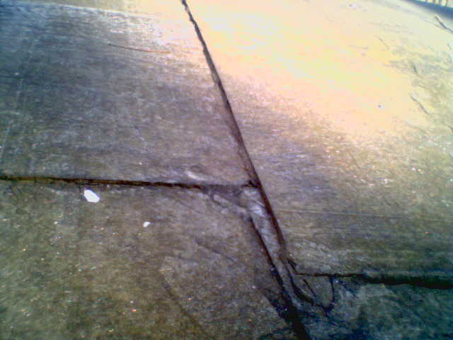

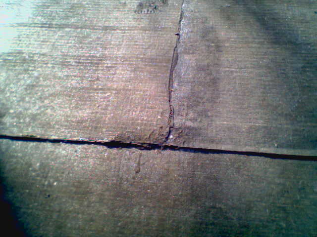

These pics are of the roof on the low slope portions of the house that (some may recall) has the “movable insulation” (beads that are blown into and sucked out of the space between the panes of the window wall.
Anyways, I have no clue as to what kind of roofing material this is. Any help?

Looks like torch down roofing to me. Not the greatest job in the world.
Is there other information I'm missing though? That grid pattern looks just like the torch down roofing I've seen.

It looks like a modified bitumen torch down to me too
I agree with zak and piffen, looks like torch down and, as zak said, not a very pretty installation.
Sounds like everyone agrees!I've never seen a modified bitumen torch down roof before. I guess they are not too popular around here.A sloppy install? Oh well. It isn't visible from the ground and it is fairly old (I'm not sure exactly, over twenty years).

If you want to sound like you know what you're talking about, call it "Mod Bit".
Or mention that you think it is SBS as opposed to APP.
"Or mention that you think it is SBS as opposed to APP."Yeah. I always try to say stuff the meaning of which is unknown to me.Rich BeckmanThis signature line intentionally left blank.
rich ,
those are two of the common types of Modified bitumen compositions sold as torch down.
Sequentured butadiene styrene and atactic polypropylene.

Dovetail,Do YOU think it is SBS as opposed to APP based on the pictures? At first I thought you were just being a wiseacre, but now I'm wondering if you were serious.Rich BeckmanThis signature line intentionally left blank.

I was being a bit of a smart a%% , but also just trying to pass on some information.
If the installation is recent the odds are it is SBS mateial. I say that because the SBS is easier to work with , melts at lower temperatures and gained the larger market share after it was introduced.
The only way to know for sure is to either find out the manufacturer (and some manufacurers make both ) or do a "heat test " to gauge at what temperature the product melts. A good "guess" can be gotten by doing a "fingernail" test , if you can push your finger nail into the material it is likely SBS, the APP is tougher and harder.

I'll chime in and say that it is APP mod bit. I used to work for a roof consulting firm and have seen acres and acres of mod bit roofs.
I don't recall seeing an unsurfaced SBS membrane, they were usually granule or foil surfaced for UV protection.
One of the first roofs I ever saw being installed was a smooth surfaced, APP, mod bit.

I believe you are right. I had forgotten that the SBS was nearly always sold with granules or needed some type of coating to protect it. I just remembered the name of the Italian company with the foil faced modified.... Imper Italia.
