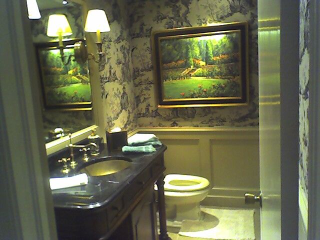

I had just about the same thing happen to me. During a bath remodel, unfortunately during demo, I turned off the wrong valve. It was a similiar bad situation. When I broke free the pipe to finish removing the vanity it spewed very hot water. After quit a while I finally got the valve on.
As luck would have it I had removed the stool already and was able to push the excess water to the drain, I messed up the sheet rock abut kept it out of the hall by shutting the door and putting my sweatshirt against the door.
As for the floor I had pulled up the carpet there and it was bare concrete.
My point is I dealt with it right then. Moped up my mess, removed base and sheetrock and the vanity. No one new my mistakeeven tho they were home.
I was lucky it was a small bath and all of was being redone. I never thought I was turning off the wrong valve.

Hey that's a good looking bath.
Nice work!"Perfect is the enemy of Good." Morrison
Beautiful bathroom. Thanks for posting those photos.
Did you do the MDF work? I use MDF quite a bit with great results.
"Preach the Gospel at all times; if necessary, use words." - St. Francis of Assisi
Yes I did all but the Toille on the wall.
I even broke the original toilet,for good luck you know, so I could buy them a new one. This bath had a final cost of just over $15,000, including the local artist painting.
