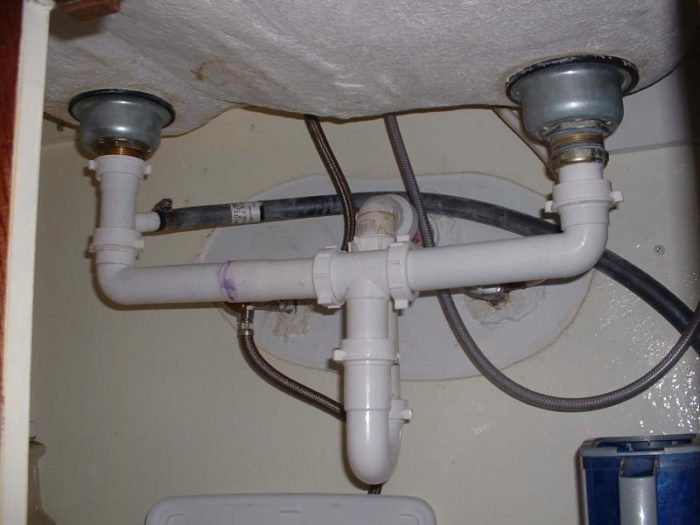

This is under my sink. I put this in about a year ago, the only gripe I’ve got is how sensitive the fittings are, one good bang under there and the chances are 50/50 I’ll get a little trickle. Note how high the drain is in the wall- it’s only about 3 inches above the deeper basin’s drain. The DW drain hose is one inch above the trapped water. Would any of you have done this differently? Would you keep it, rip it out, or change a thing or two? Any criticism will be appreciated.
maybe this picture will be better:
Start ripping.
The waste line entering the wall should be lower than the sink cross overs.
You created a trap that includes the drain cross overs.
Dave
Thanksfor your answer, I was afraid someone would say that. I didn't like it from the moment I realized what I'd done.
