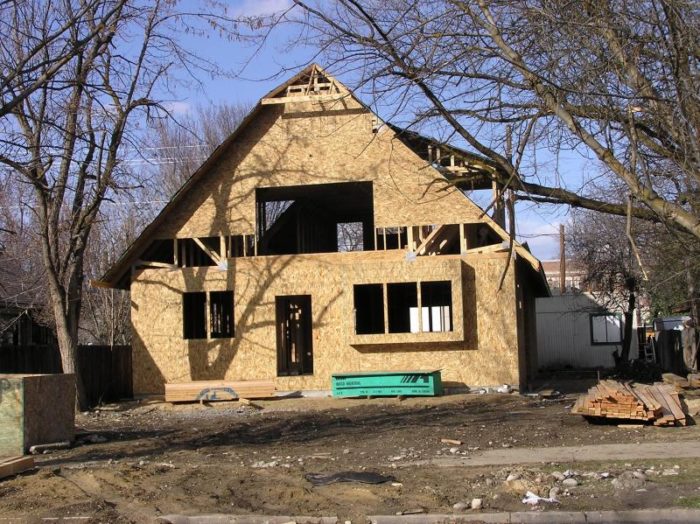

Putting this out as sort of a case study, a home around the corner from my sister’s house that is in a historic district was to have some work done. This is the wording from the actual permit all permits/ inspection records are online line in our town for public viewing, as are tax records for anyone in town. So the information I am posting is public knowledge have an address anyone can look it up.
This project is for the razing of the rear portion of an existing single family dwelling; lifting the remaining structure to allow for the excavation and placement of a new 1093s.f. basement, 486s.f. of added area to the rear main level on a typical foundation and an addition of 784s.f. of upper level. There are new code complying stairs throughout. R1CH ok per DRH07-00485 by Julie Archambeault. Separate electrical, plumbing, mechanical and ESC permits are required. A performance bond is required at $3.50 per s.f. being $5000.00. All per the approved plans as marked REScheck and the plan review notes. pep
Okay, this is what happened;
1. MY sisters and her family go away then come back and the house in question is knocked down, I was at her house working while it happened.
2. They excavate and set footing for a full basement.
3. Footing forms inspected footing is poured.
4. Foundation forms set inspect poured.
5. Framing starts is 90 % complete project gets Red Tagged.
Why read for your selves.

Just an update work is stop and they now have to go to the historic district on April 14 and;"Request Historic Preservation approval to modify their previous application for a
partial demolition and addition to be for a full demolition and rebuild on property
located in an R-2H (Combined Residential with Historic Overlay) zone."Just as a side bar some historic districts are notorious for dictating what can be done, down to approving paint colors by having layers analyzed to determine the first color ever put on the house, and then that is what must be used. Districts in New England are like that.Our District is not too bad over all, the business district I earlier discussed was pushed by outside forces, to preserve (the neighbor association and not the city). The district is more concerned with appearances from the street view then what can't be seen. Bad if you own a house on a corner. I had to replace two five panel swing out doors on a one car garage, high visibility from the street convinced them a 8 panel overhead door achieved the same flavor, was a go. Some HO Associations are worst then our historic district!One last note the homes were first then the district, but these people bought the house knowing the district was in place for several years.Wallyo

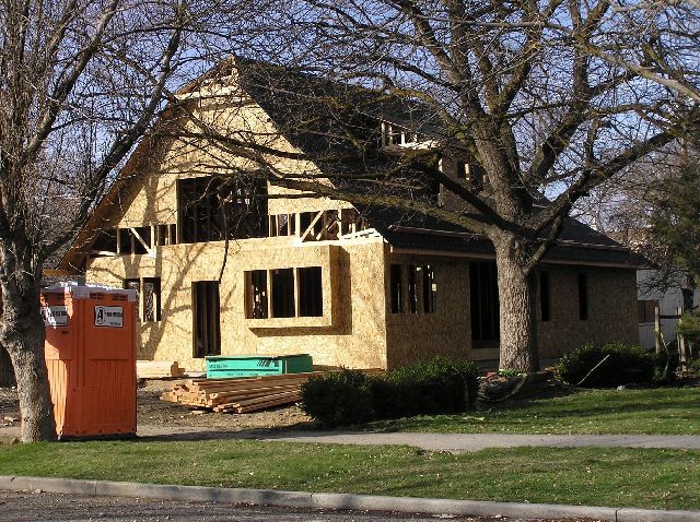

Looked at your picture, and I had to laugh.It doesn't show the "character" of the neighborhood, but that house looks very very bland. Certainly unlike anything in a "Historic District" in my part of Ohio.And those jalousie windows flanking that half wagon wheel light on the front door. Certainly wouldn't want to mess with those historic features for gawd's sake.John Svenson, builder, remodeler, NE Ohio
I should of described the neighborhood it is filled with 1900's craftsmen bungalows, I never said the house was historic I pointed out it was remuddled.If someone wants here is a real cool thing Google did this in the summer they took pictures with a van and 360 degree cameras drove down almost every street in town about 80% of them. it is on the web and you can drive down the block from your house in Wadsworth. Only one of four cities they did.http://maps.google.com/?q=900%20e%20bannock%20boise%20idaho&t=h&utm_campaign=en_US&utm_medium=ha&utm_source=en_US-ha-na-us-gns-ssm&utm_term=addIf the link does not work go to Google map.
